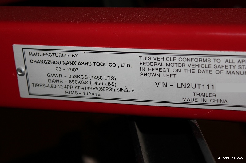

            A few folks mentioned that these trailers didn't have VIN tags. While some may not, I thought I remembered having one on mine. I went out and took a quick look and I do in fact have one on mine. It also came with a certificate with the same info that I brought in to the license center for the MN lifetime trailer sticker.
            Here's a rather out of focus pic (you'll have to trust me that precarious balancing was involved)
              #36
              The description says the trailer comes with 4.80" x 12" tires. Did it come with something different when you bought yours? What was the reason for changing the tires?
              All this talk about trailers has me thinking I should get one - much easier to load equipment onto a trailer than lift it into the bed of the truck.
              Yes, the one I bought had 8" or so tires. Since I anticipated driving lots of freeway miles and since the hubs warmed up I went for larger tires. Larger tires slow the bearings down a whole bunch which means less heat and longer bearing life with the added benefit of increased ground clearance.
