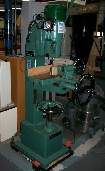

              You are fine cutting them with your Shop Fox. I used one for about 7-8 years before I got my current little mortise machine. Every type of hollow mortise chisel machine is going to leave a somewhat ragged bottom as the spur on the bit has to slightly exceed the end of the chisel to take the main waste out. The chisel merely collapses what is left after the bit drills out the main waste.

                I use a Jet hollow chisel mortiser. I make a second pass on my mortises where I take tiny little bites, going forward only about 1/8 inch or so at a time. It cleans up the bottom some. It still is not smooth, like a routed mortise, but it is better. I also cut them a little extra deep, like 1/8. Before I started nibbling a pass, it was too rough at the bottom to work with the mortise only 1/8 deep.
