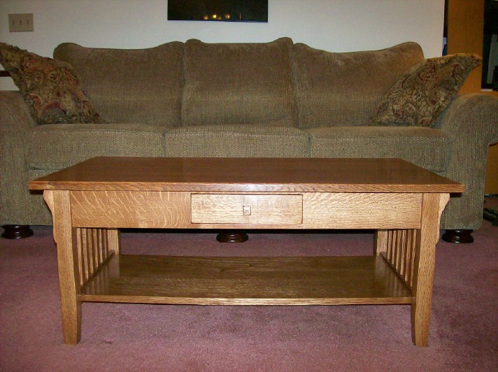

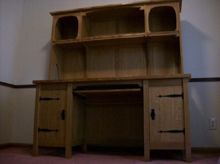

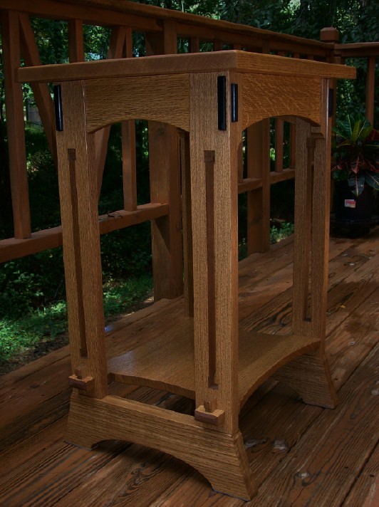

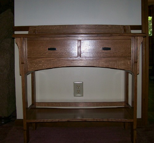

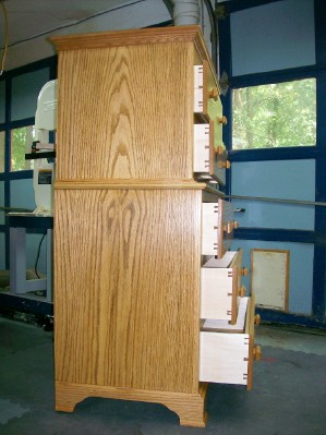

        I am going to post 5 projects that required a lot of chisel work done in the last year. I can tell you that I have no real clue as to what the current angle on my secondary bevel is and could really care less. I can also tell you that at least one of my tips is slightly skewed and not square to the chisel. But.. I can see that and simply compensate when using by skewing the hold. And a skew comes in awful handy cleaning out hand cut DT waste and any other corner angles, etc.
        Now find the flaws in the project pictures after I tell you I have no true clue what the angle is.. that at least one of my tips is skewed and not square.
