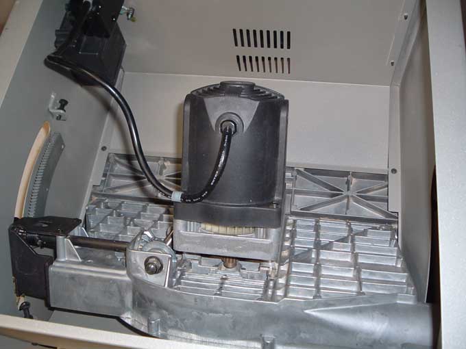

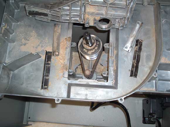

                  Well, I'm glad I did take it apart. Here are before and after shots.
                  I believe there is a little known fact about this saw that is not talked about. It makes sawdust. Where does this stuff hide? Every time I would move it there was more sawdust. I wasn't sure it made a difference if the shims were put back in the way they came out but I didn't want to take the chance.
                  I have 18 pictures that I took while doing this. If there is interest, I can post them with comments or I can answer questions as needed.
