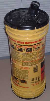

    For those considering the Thien Cyclone on a 5 gallon can, think twice!
    Twice the capacity I mean. By combining two 5 gallon plastic cans, I now have something just shy of 10 gallons. I can now do a lot more planing before emptying the cyclone. That's nice. And there is less chance I'll overflow and fill up the paper bag in the vac, like I did the other day!
    After cutting out the bottom of the upper can, I cut about 1-1/4" of the bottom of the lower can. This allowed me to pound them together and the fit is so tight that they seal themselves. A few short sheet metal screws and...done.

    Now, there's a thought.
    Great idea. I've been looking for a 10 gal. can for the same reason. Never occurred to me to use two 5 gal cans. Does that make me dumb or just slow?
      I would say neither rberry, just inexperienced. Once you start doing a lot of woodworking projects, your brain starts thinking in different dimensions and your creativity and problem solving skills improve. You'll see
        Hmm.... I will have to remember this idea. You might still think about a bead of silicone around the joint on the buckets. My experience is things like that will eventually leak if they are allowed to.
          A lot of five gallon buckets, will fit into one another (at least the ones I have access to). Why did you place the open end down, with a lid on the bottom instead of using the existing bottom?
            Because when they stack top to bottom they don't get twice as tall???
            and you only get 2 x 5 = 6....

              Exactly. And if you join them end to end without cutting off part of one of them, they will not slip one inside the other.
              An additional word about this. I looked at the bucket stack this evening when I was vacuuming up the tools and I realized that the center was sucked in to an oval shape. That's without any real resistance as I was using an open 1-1/4" hose on the end of the 2-1/2".
              I guess I'll have to figure out how to make a wooden yoke to go around the center to keep them round. 2 pieces of some old 1/2" plywood should do it.
                You could just put an X inside. Let the screws that hold the pails together hold the wooden X in place too.

                  I'm wondering if a wooden support inside would interfeer with the cyclone action. Being that far down it may not. It would be worth a try. No harm in that.
