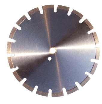

    IF you only want to cut a few, a concrete blade on a saw should do it. Get a mask though!

              Ive cut a bunch of concrete with my circular saw and an abrasive blade.
                My thoughts too....diamond or carberundeum blade will work well and leave a pretty good cut.
