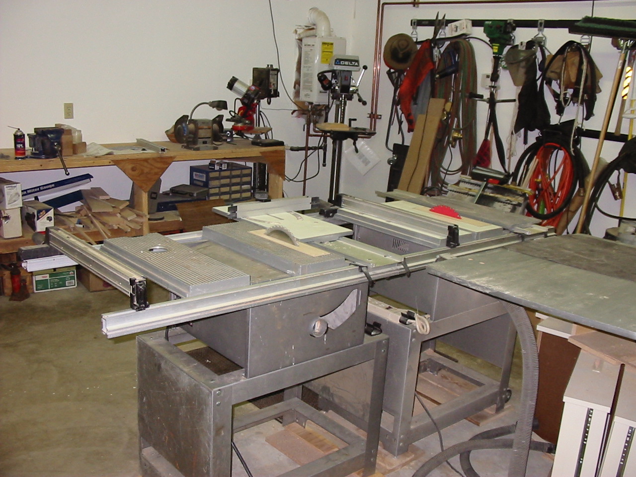

                        Well I finally made the switch to 2 saws today. I bought another BT3000 a few years ago just in case I needed some parts. Paid the guy $50.00 because it needed belts and he had it apart in boxes. I allways keep a spare set so today I put it together! Allt the parts were there even the screws! Now I have a Freud Glue Line LM74R010 30 tooth for ripping and a 40 to 60 tooth for crosscutting.
                        Cork,
