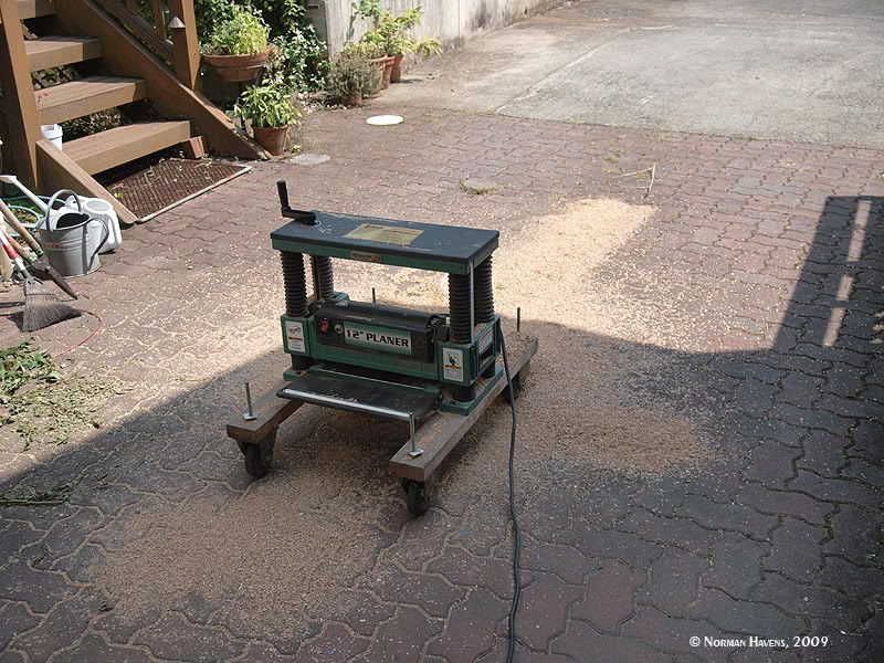

      It's sad, but knives are built by third-party vendors so cheaply that it's hardly worth it to have them sharpened (certainly not if done professionally). I keep thinking I should get a good rotary sharpener and do mine myself, but haven't done it yet.
      And speaking of weights, my Grizzly is 85#, but I like it heavy for stability's sake. I have it mounted on 2x4s and casters to wheel it around.
