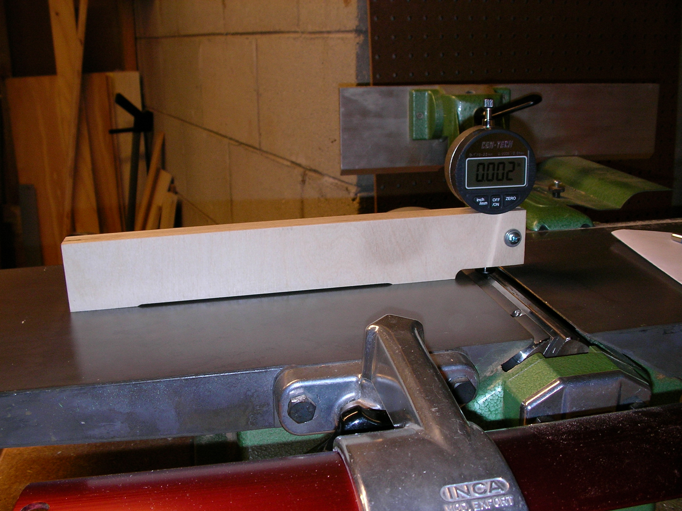

      I have seen a couple videos on youtube where they use a dial indicators to set the knives- this looks pretty accurate. What method are you using? dc
      Time flies like an arrow, Fruit flies like a banana.
        Make a jig to hold your dial indicator. If you don't have a dial indicator, get one. You'll also feed a flat tip.

            I've never used a dial indicator. Guess it would be pretty accurate. I use a piece of paper as a scuff dimension.
              i built a jig kind of like Cgallery's (Phil's).
              I had to futz a little bit to get the right height, but the jig helped me set the blades all to the same height. It still cut a bit concave even though i thought they were perfectly even and level with the table. I found out that meant the height wasn't perfect. At first i was afraid i'd have to reset them all, but after a bit of futzing i learned the outfeed table height adjustment (yeah that's what it's for) could be used to make it right after the knives were evened up even if the height weren't correct after setting them all. You can quickly go thru several heights to find out which work right. $8 HF dial gauge - another HF gem. The good thing about the dial gauge is that its lightly spring loaded to keep it in contact with the item being measured. A lot of jointers use a set screw to set the hieght so you can bring it up against the spring load and not take too many hands.
              Anway, now it cuts perfectly.
              Construction notes: the stem on the dial gauges is 3/8", a standard, i think. I used the bandsaw to cut a slot and there's a set screw to tighten it up on the stem. I used a nice flat laminated board about 15 inches long but I think maybe Phil's idea of a couple of feet may be a good idea.

                    I have found a source of flat contact points
                    www.use-enco.com catalog #325-1380 but they cost about $4-
                    something each and also there’s a $5 shipping cost involved. That makes a $9+ point for a $7 gauge.
                    I do have an article that describes dial gauges, details of these contacts, and how to make your own workable substitute points.
                    Send me a PM with your e-mail address, ask for the dial gauge flat contact PDF file.

                              Enco also has that kit, but i don't find it nearly as useful as the flat contact.
                              The Bob Vaughn video, he recommends a button head contact, but you have to slide it back and forth to make the high point of the tip match the hjigh point of the blade. I prefer the flat contact tip myself, in a 1/2" or 5/8" diameter. It allows you to set the dial indicator over the blade within about 1/4" and not have to futz with it anymore.
