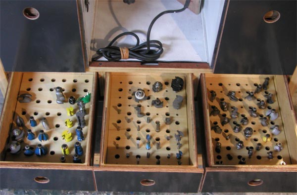

        I can't comment on the differences you asked about, but I do use pocket holes. I have several items - a cabinets hutch, bookshelves and lathe table and a large router table/cabinet made with pocket holes and they are sturdy. Knowing that I would be taking some of these back to the States at retirement and also knowing that I would be somewhat limited in space, I made these with pocket holes for strength while the screws would allow dis-assembly for shipping.
        I was concerned with strength at first but learned the concept that if it is square and butt-joined correctly, the proper screw made things very strong.
        I have learned how to assemble with PHs while hiding the holes. It takes a little forethought but it can be done. Below is the router table done totally in PH screws. It was made about 7 years ago and has survived a move by a moving company without disassembly and remained square as the day it was finished. (I will add that the drawers were done with slot joints and glue.)
