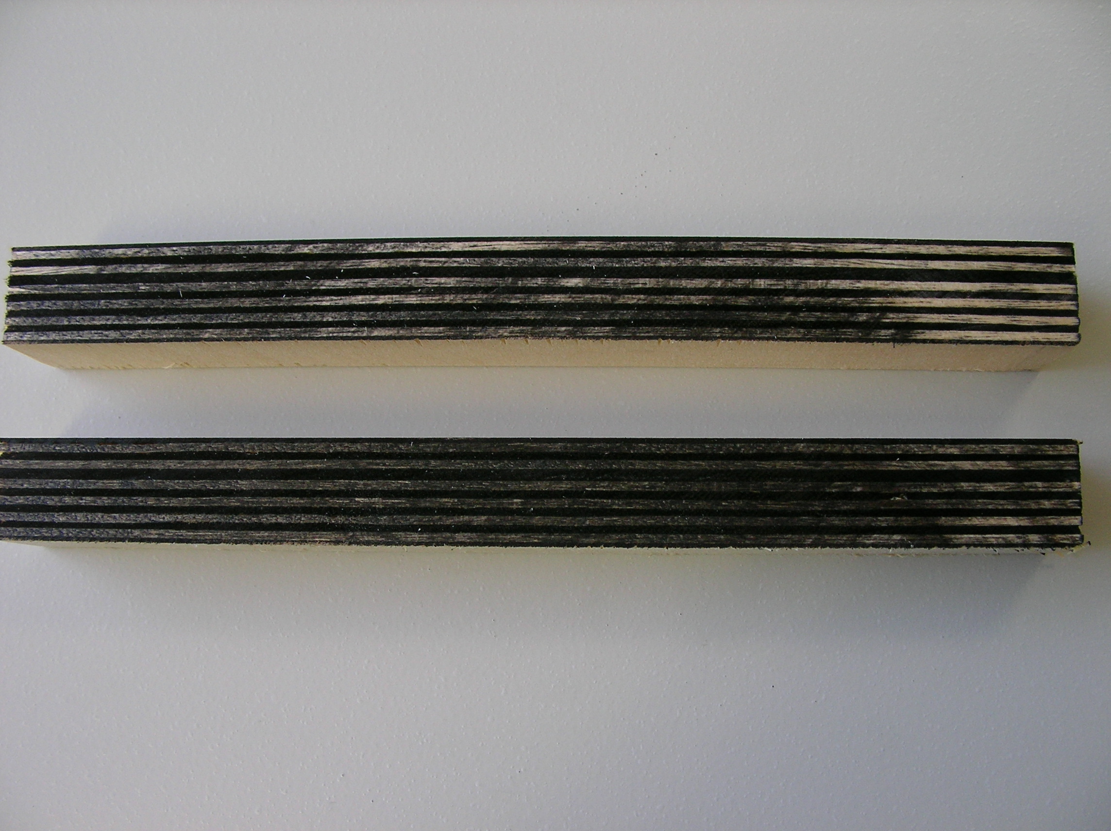

              I came up with a test which I hope will demonstrate the before and after.
              For the test, I used my sled to cut a piece of BB plywood that is approx. 7 or 8" wide. I then used a black marker to color the cut edge.
              Next, I placed the wood back on the sled, and ran it into the blade five times. On the fifth pull back to the front of the saw, I paused for five seconds.
              The top is the piece w/ no stabilizer in place, the bottom piece had the stabilizer in place.
              Besides seeing that the piece cut w/ the stabilizer in place is "more black," I can also tell you that it is straighter, with fewer light gaps than the piece cut w/o the stabilizer.
              That's my story and I'm sticking to it.
              YMMV.
