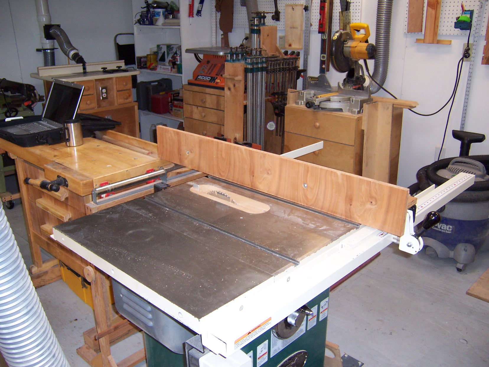

          Tall Fence
          I made mine out of birch ply instead of MDF to keep it lighter and it was what I had on hand at the time. It only took about 1 hour and should last a good long time, it has proven to be a help in ripping long sheets of ply and provided a place to attach a scrificial fence. Good luck with yours.

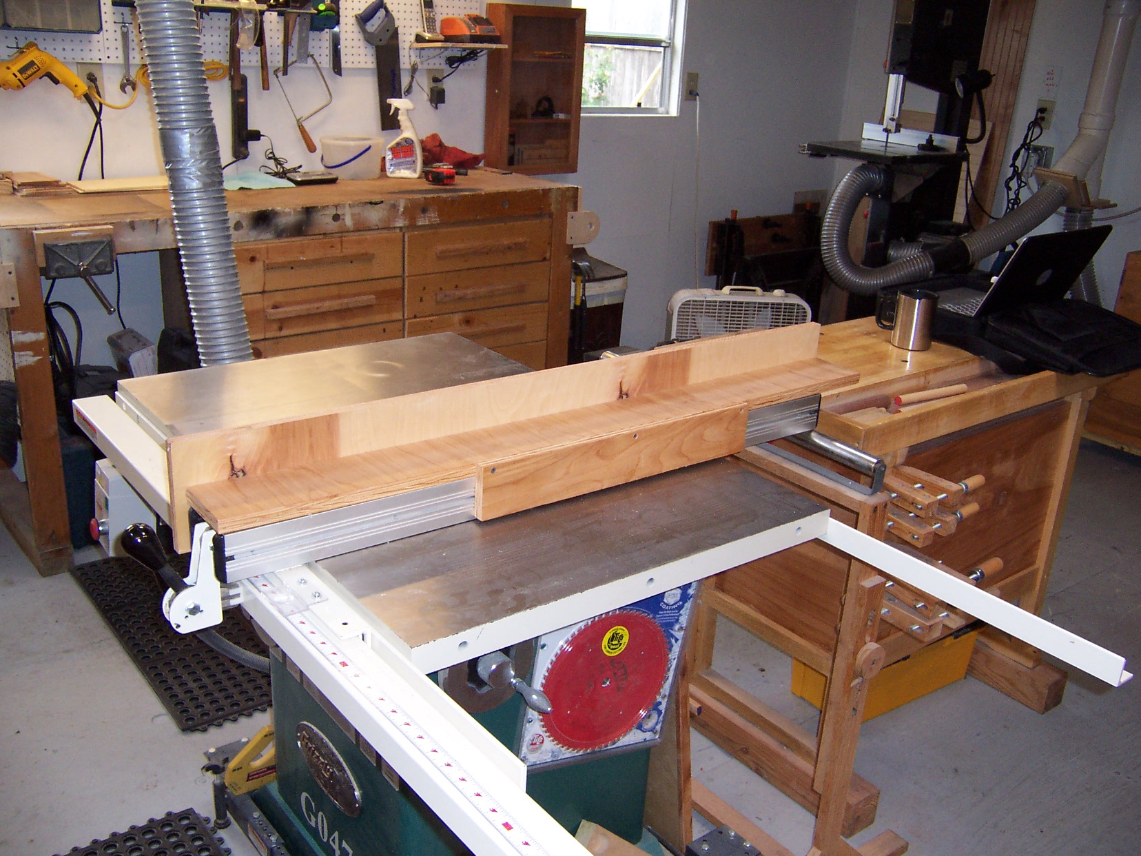

            • 21993
            just a piece of 3/4" plywood, about 8-10 inches tall.

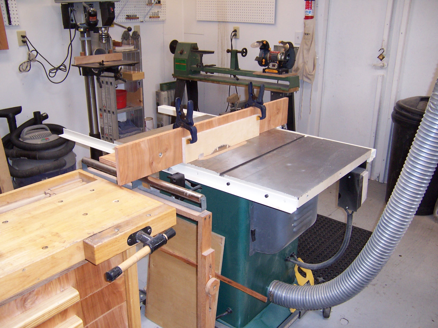

              On my now-retired BT, I used a piece of 1/2" Baltic birch plywood some 30" long by 5"-6" high. (On my cabinet saw, I've needed sacrificial fences but so far not a taller one.)
              One nice thing about the BT, if that's what you have, is that all you need is a couple-three T-nuts of the correct size and the auxiliary fence can be a simple slab that bolts right on. With other saws, you'll likely have to do something similar to what Larryl pictures.
              This is elementary, but if you use the scale on the rails, remember to recalibrate your rail setting to account for the auxiliary fence's thickness before making that first critical cut. (No, there's no "DAMHIKT" involved here, I'm just mentioning it because it's something that could easily be overlooked.)
                Mine is made out of ply and is about 3" tall. I made it to slip on/off the fence rather than be permanently attached.
