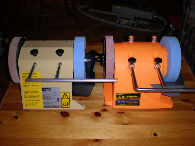

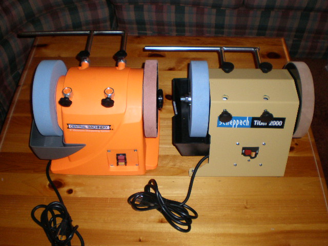

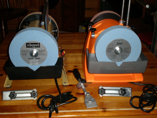

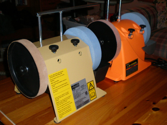

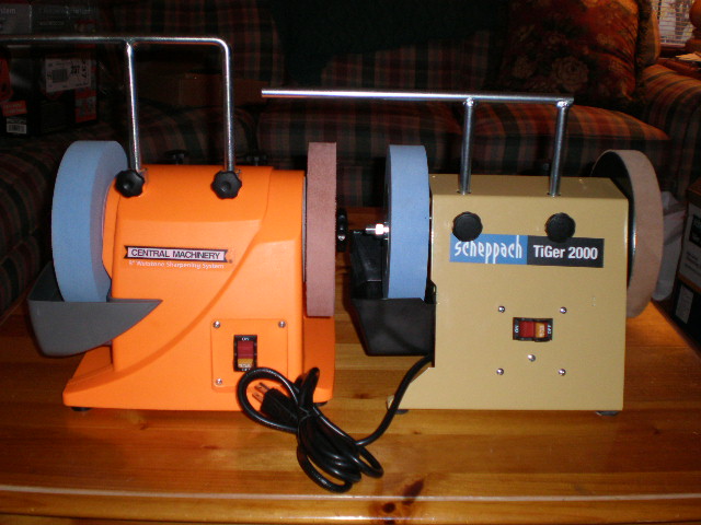

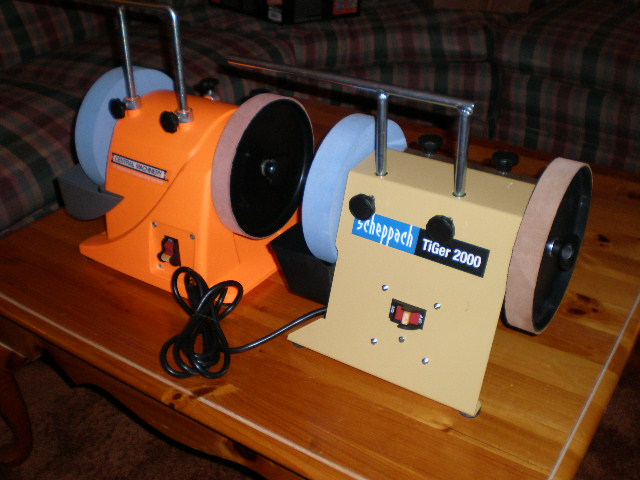

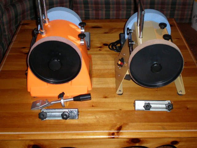

            I own the HF and the Scheppach Tiger. The units are more similar than they are different and many of the parts are interchangeable. The primary difference is that the base on the Tiger is made of metal and is more substantial than the HF unit which has plastic base and is lighter weight. The tool rest seems to fit more snugly in the Tiger giving a Tiger a more sold feel. However, both units seem equally functional. I am delighted with my sharpening results. Much better than using stones for initial grinding.
            The grinding and honing wheels on the two units are identical. The tool rests are identical except for the method used to achieve to right angle bend in the tool arm (welding vs. bending).
            The HF unit has a few of advantages over the Tiger.
            1. HF comes with a small knife grinding jig which is not provided with the Tiger.
            2. The base on the HF unit allows the tool rest to be affixed at a greater range and distance from the grinding wheel. However, I haven't found a practical limitation with the Tiger.
            3. The direction of the threads on the shaft which holds the grinding wheel in place with a nut have been reversed on the HF unit. The nut on the HF unit is tightened with a counter-clock wise action which is opposite to the direction of rotation of the grinding wheel. This is an improvement to the threads on the Tiger where the nut tightens in a clock wise direction, the same direction as the rotation of the grinding wheel.
            4. The specs on the HF motor appear to be slightly better than the Tiger, although I haven't noticed a material difference in use.
            Grizzly just introduced a 8" unit for $119.95 which appears to be similar to the HF unit. The plastic base is green instead of orange but it doesn't come with the small knife jig provided on the HF units.
            http://www.grizzly.com/products/t10097
            I purchased the Accessory Kit 2 from Grizzly and several of the jigs from Jet. They all work fine with the Tiger and the HF unit because the diameter of the tools rests are the same. The same would appear to be true for the Tormek Jigs, although I have not tried them.
            http://grizzly.com/products/Accessor...-T10010/T10024
            http://content.jettools.com/manuals/m_708015.pdf
            Here are some pictures to show how the HF and the Tiger visually compare. The tool rests on both units are shown in their fully extended positions.
