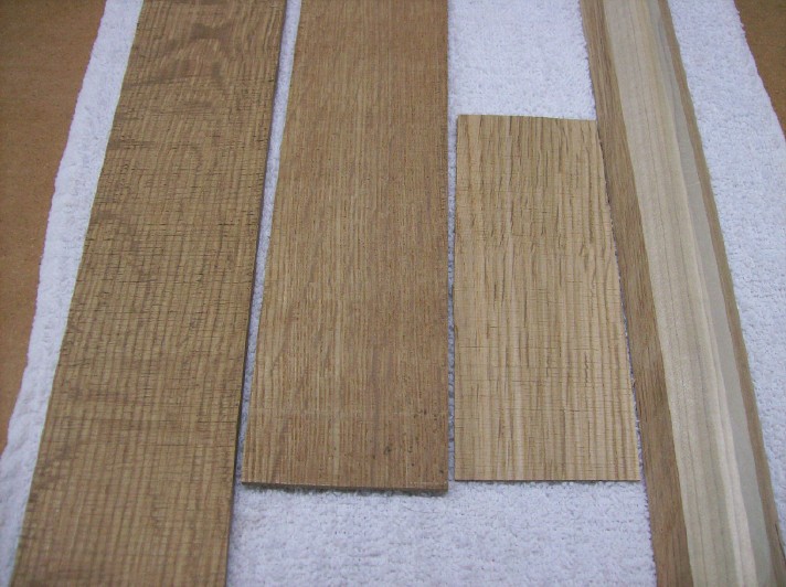

                Here is a comparison of cuts... you won't see a major signifcance in them with 3 different blades but.. the carbide stays sharper longer.. with bi-metal next and then standard carbon.
                From left to right.. Timberwolf from a Jet.. Steel City 18" with a bi-metal and a Mini-Max of my neighbor up the street with a carbide. The leg component on the extreme right was done with both sides at 45* angles on my TS with an Amana 20 T rip blade.
                You will see the Timberwolf with not quite as good a cut... the Steel City with excellent using bi-metal and better than the carbide in this case to the right of it (3 rd from right in picture) but.. but.. my neighbor Bill won't change his carbide or get it sharpened until just before the teeth are about to fall off. He does outdoor furniture for a living and the cut doesn't matter to him. So.. in this case the bi-metal which was sharp gave a better cut than the carbide which has seen a few miles.
                But.. all... repeat all re-saws done with a BS need to be cleaned on the showing side. You can get away with the cut on the glue side but the show side will always require some clean up. A Bandsaw is just not going to leave a cut as a TS. That picture to the right is testimony and it was done with a 20 T rip blade which left a glue surface in this case.

                  Your picture of the Timberwolf results are consistent with my Timberwolf results - needs a few shallow passes on the jointer to clean up, sometimes more. Hoping the Diemaster2 will reduce the amount of jointing required.
