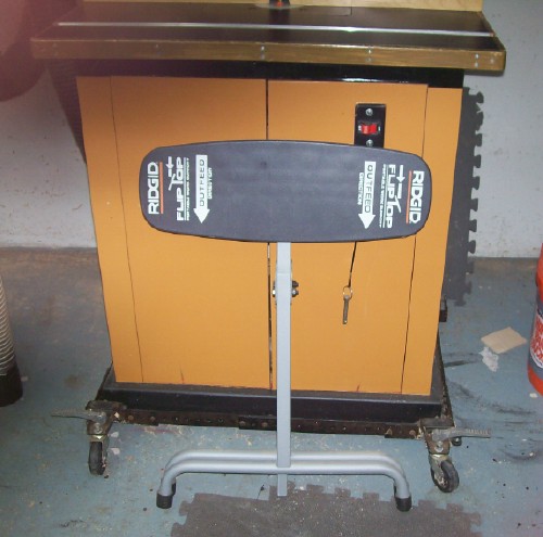

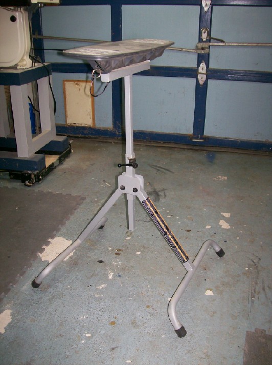

              Here's the picture of the Ridgid flip top stand you requested by PM Bernie. If your local HD doesn't have them... I can get you a HD SKU # from my local. Or.. or.. if you want to save money.. you can continue to use the stool you referred to in your PM.. make a block that would shim a piece of MDF table to the height you want on you TS.. then screw it down counter-sinking the heads. That would work fine but.. you can fold it up and the space it takes is just the space it takes.

                Adding to what Sarge wrote, I'll pass along an excellent piece of advice that someone here (I think it was either Ken Massingale or sweensdv; apologies to whomever if that's wrong) gave me when I decided to buy one of the Ridgid flip tops:
                While you're at the store, go ahead and buy two of them, to save yourself the extra trip back to get another one. They're that good.

                  #23
                  Thank you very much, Sarge. According the the internet, my local HD is supposed to have them. A personal trip for that and some MDF is in order!!!
                  Bernie
                    I originally puchased two.. loved them and the company I retired from purchased two more for me when I agreed to build them a round 100' show-room counter as I needed pleny of support doing sections 10'-12' long. I purchased another just after I sold my Uni-saw and got the Steel City 5 HP to use for that rear extention.
                    So.. what you say is the truth.. the whole truth and nothing but the truth as I see it for my own needs.
                      #25
                      If you get one.. write the SKU # down as you will probably want a couple more in the future. My local did not have them for over a year making me think they had been dis-contined but.. they showed up again about a month or so ago. You never know where they will put them either. I have found them in Tools in one store and with accessory tables and ladders in another.
