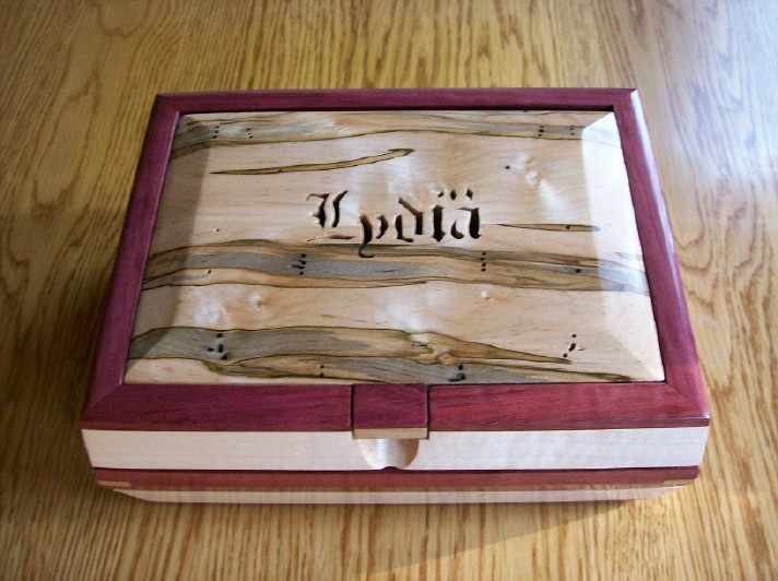

          I used to use a cheap scroll-saw for a few odd jobs and it was really a pain. To the point I really had no confidence in scroll saws what-so-ever. About the same confidence I had in a jig-saw as I felt it was useless... until one day I bought a Bosch barrel grip JS to do a commercial round job.
          The same happened with the scroll-saw the day I purchased a factory re-conditioned DW 788 from a DW rep who is a friend. He got it for around $250 his cost for me. It has set for almost two years as I just didn't have time to learn to use it. But recently it got the call with me as a very inexperienced Scroller. I played for about an hour or so and scrap and then took the plunge knowing I would not get excellent results stemming from my previous SS encounters.
          But.. IMO a good SS made a bunch of difference as I feel confident enough to do it blind-folded now. Well.. maybe not that confident but a good SS made a huge difference in my earlier failed attempts. So.. a better saw of some brand may cost you but I think it will pay for itself in results.
          My first real attempt on something other than shop grade cuts...

            Very nice work sarge. I am in the process of looking for a new saw one that pinches the blade instead of tightening a screw agianst the blade. How is the blade held in the dewalt? Right now its a toss up between the dewalt and the dremel.
            www.acadian-woodworks.com
              It's a thumb-screw with twin T knobs and it basically does just pinch the blade in. At first I had trouble doing it and in those Old English letters thought it would take forever having to take the blade off and move to the next cut as some letter requires 3 separate cuts.
              But.. after about the 3rd letter.. it got easy.. very easy as I just became familar with the procedure. I was using SR reverse blades and it was hard on these old eyes determining teeth up and down. Those blades are tiny I tell you but... those SR Reverses left an extremely smooth cut in ambrosia maple and the DW didn't have any vibration. I have it mounted on a mobile Tri type stand so I can sit at it when I park it.
              I have not used the Dremmel but I can vouch for the DW. Ron Brown is a SS guru local and worked demonstrating the DW for DeWalt at shows for years. There is also a very large SS Club in my county but I do not belong.. at least at this point as I really don't have time to specialize as large carcass furniture has been my forte for 37 years.
              Those boxes were my first and first small project I have ever done. Anyway.. the DW is a winner if you can squeeze out the dollars. Or.. you could look for a Hawk.. etc. on Craigs-list if you are going to be a serious scroller as many in that club I mentioned are. Most don't do furniture which is similar to some turners I know.. I suppose they are just hooked on scroll or turning as they find it enjoyable.
