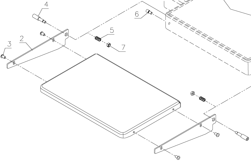

      A slightly reduced rant . . . . .
      There is a small opportunity for adjustment of the tables because the holes in the table brackets (Part #2) are elongated vertically allowing for a small amount of up-and-down adjustment. All that is necessary is to loosen the attachment screws (Part #3), adjust the table (no number) and retighten the screws.
      In exhaustive ten minute study, I was able to noticeably improve the alignment and hopefully reduce snipe, at least for small parts, until I get the sled built.
      Regards, Steve
