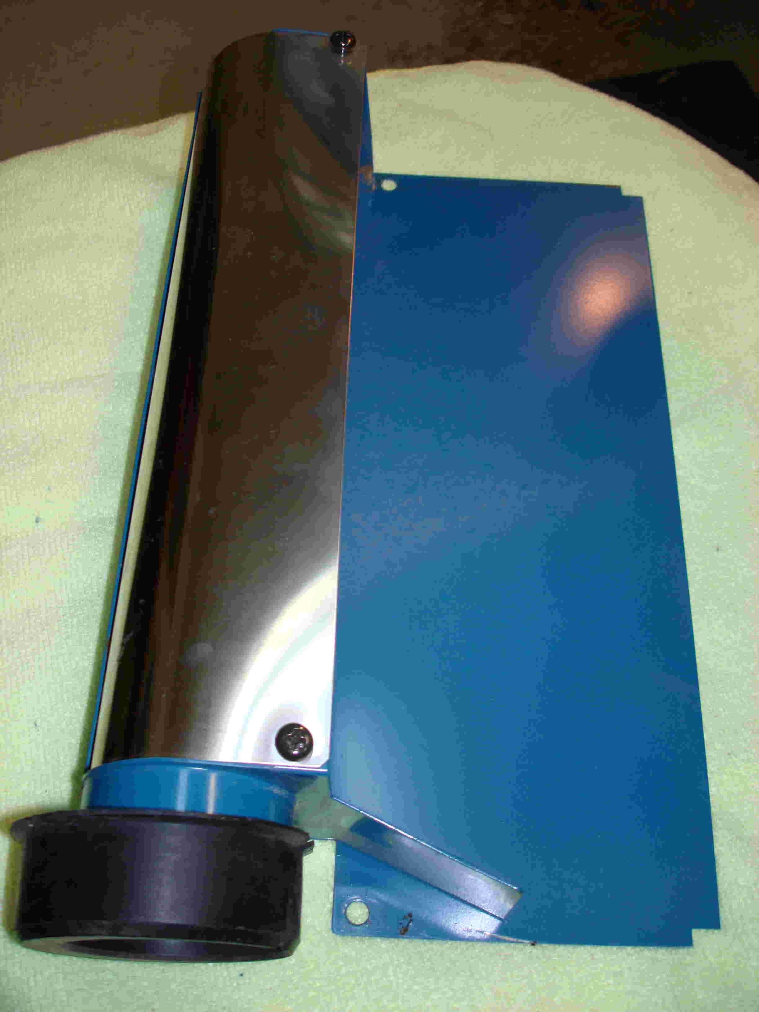

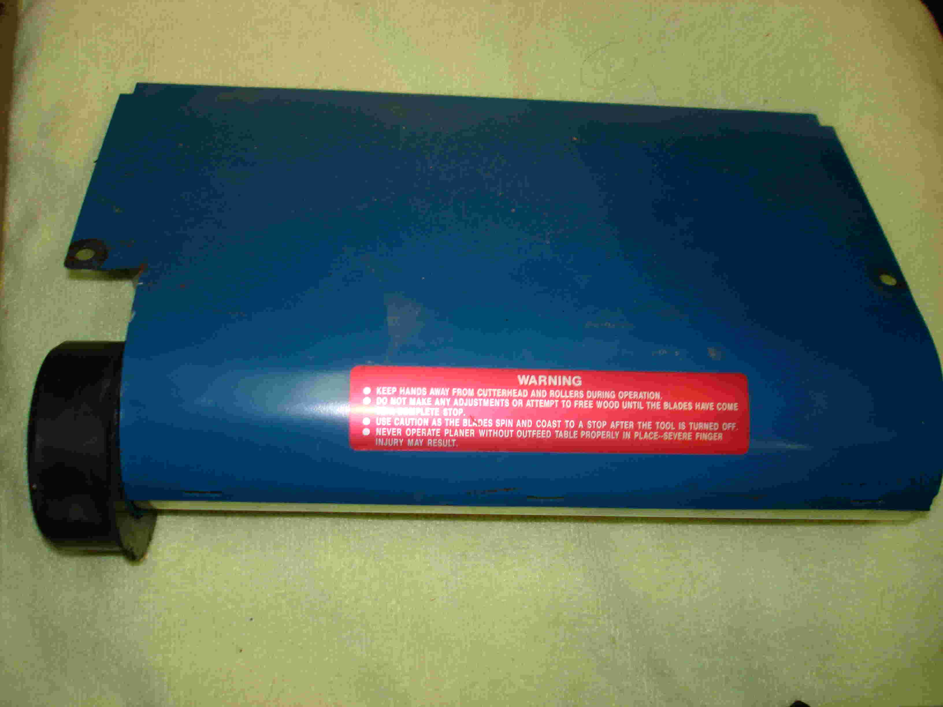

        Ryobi did make a dust collection hood for the AP10. It was a replacement part. I do not recall the number.
        The dust collection hood is an odd size and requires a special gasket to hook a regular shop vac hose to the hood. I will try and get some pictures.

          Here are the pictures of the dust hood
            Thanks for the pictures of the dust hood. Now if I knew the number and could find one.... I was thinking of putting a 4 inch DC connection in the middle of the deflector piece - interesting that Ryobi put it on one end.
