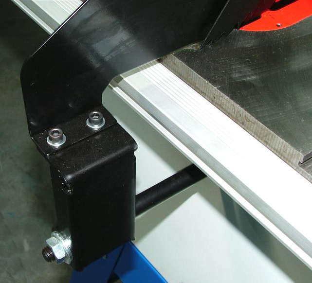

                      A fellow woodworker named Bob Ross who spends time over on the Woodnet forum has developed a "Bolt On Ripping Knife" (BORK) that attaches to a few popular current tables. By all definitions that I'm aware of, it IS a riving knife that rises, falls, and tilts with the arbor, as opposed to a splitter that is either stationary, or only tilts with the arbor. I know that current versions fit several of the Grizzly 1023's and nearly identical Shop Fox cabinet saws. There's also one that fits the popular Craftsman "zipcode" hybrids (22124 and 22114), and the similar Steel City hybrids.
                      My "BORK" has been in operation in my new Shop Fox W1677 (a white Griz 1023SL) since August. In it's current configuration it's a simple installation that requires some dexterity to optimize, but once dialed in, the BORK works as promised. Mine was considered one of several other prototypes for testing, so I'm not certain how different current models are, but the components are simple. There's an arm that attaches to the top of the arbor swing arm with a custom U-bolt, and some proprietary hardware that holds the riving knife. It took some effort to extend the kerf of a phenolic ZCI, but once done, with the knife properly adjusted, it works quite well. The BORK can be adjusted for full or thin kerf. Some of the complications that Bob had to consider are other existing physical components of the saw that interfere with the full travel. The BORK's current design incorporates some flex around the these components. I'll post some pics below, and will try to send a PM to Bob to get him involved with the discussion because there will undoubtedly be questions for him.
