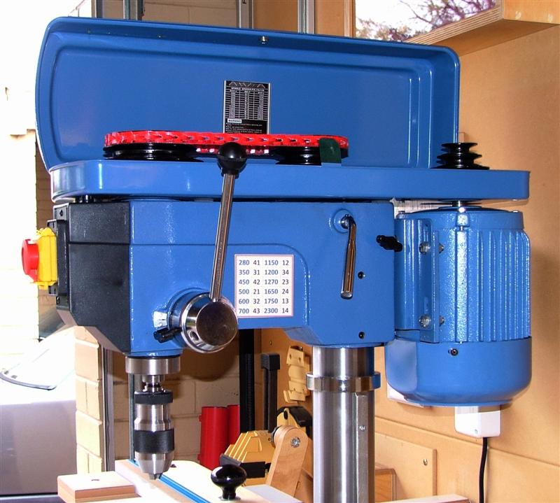

            How well do link belts work on a drill press with step pulleys?

                I bought one to fit on my DP and found that my DP needed a 3/8. The 1/2 was too large to fit the step pulleys of the HF DP. I got the 3/8 from Grizzly and ordered two. The extra length came in handy for a buffer mandrel that I set up.
                  Perfectly (Lower one hidden, obviously)
