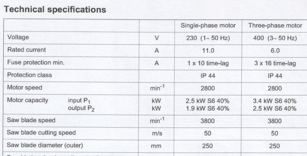

              Maybe my confusion came from looking at my table saw spec.
              This TS comes in two versions - 1 phase and, 3 phase (I have the 1 phase).
              As you can see on the pic below, the 1 phase voltage is 230V but, the 3 phase voltage is 400 that if I'll apply the formula of "square root of 3 multiply by 230V" it will give me 398.37V (or rounded, 400V).

                          As for the 230/460V in Europe, I have a little bit of confusion because my TS is made in Germany for the European and Australian markets and if they say "3 phase 400V" (as you can see on the spec of the TS - taken from the Operating Instructions that are written in all the main European languages including Polish) so, I believe that the Germans knows the electric power in Europe.
                          Again, I don't have any idea about the 3 phase voltage to the industry in Europe
