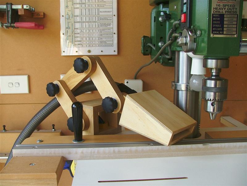

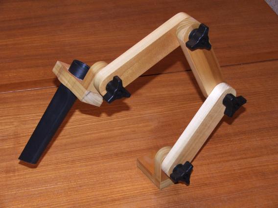

        Here you go...
        I still use it all the time (Shown on the old DP)

        Downunder ... 1" = 25.4mm
          Rod,
          That looks great! I was thinking of one of the semi-rigid hoses but I think you gave me a good little project for some scrap plywood. It looks like you use 19mm but I have 11mm but I think it should work OK.

            Please note: Mine is from a ShopNotes design.
