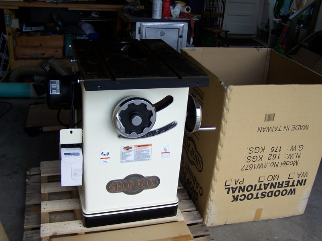

    Here's what I've been up to since yesterday...My trusty 22124 has found a new home and my Shop Fox W1677 has arrived. I'll miss the 22124 but the 35% off the SF with free s/h was more than I could take! My saw has gained some weight but my hand plane collection is a bit lighter now....had to peddle some of those to fund this thing! The driver showed up on time and loaded this in the garage for me...he was a wwer too and was pretty interested in the saw. He wouldn't take a $10 tip, said his saw blade collection was pretty vast, but he didn't own any chisels so he accept a nearly new box of chisels (remember the $8 Northwest Tools deal with free shipping?! ) There were at least two happy people in the world at that moment...me with my new saw and him with a nice looking box of chisels!

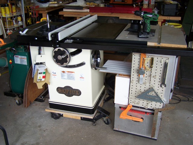

    Just about everything is super heavy duty...handwheels, lock knobs, switch, trunnions, miter gauge, motor...even the motor cover is heavy steel. I miss the Biesemeyer fence already though, but the SF Classic will be fine. The ivory color is nice.
    I removed the cosmoline with engine degreaser and it worked like a charm. I Needed the saw to cut the platform on the mobile base, so it's running but far from trimmed out. Still need to hook up the switch, level the wings, hook up DC, align it, bring it with the level of the workbench, and have much more work to finish install the router table and a new outfeed. More to come...

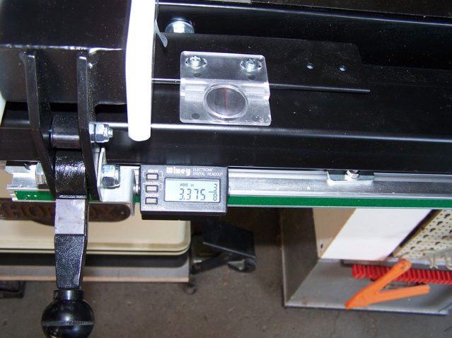

    Update: Added the Wixey digital read out that my best friend gave me in March. I opted to only use half the rail which gives 30" digital capability...the full two section 60" would have alot more overhang and my fence only goes to 36", so I'll have read the old fashion way for over 30". ...it's great having a generous friend who's also a wwer!

        Looks like a beaut. Kinda like a white Grizzly. I'm sure cutting with it will be pure WW joy. Pat

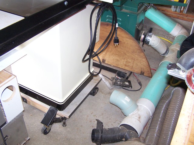

          Very cool saw, must be nice to have enough room to work with something that big!
          One question I have though...
          Is that 6" PVC sewer pipe you are using for your DC plumbing? That must be one heck of a system to utilize that! Might want to keep hand tools and small animals away from the inlets on that thing!

              Man, my shop is pretty small! The footprint I'm allowed is about 10' x 13' (a bit under half of two car garage), but I do have temporary auxiliary floor space if needed, and airspace above the bikes and outdoor toys!
              Yep, that's 6" PVC hooked to a Griz G1029 2hp w/12" impeller with a JDS cannister filter. Ever since I hooked up the 6", the separator gets sucked clean, which defeats part of the purpose of it!

                Are you going to install your Wixey Digital Fence on the new saw?
                • Knottscott
                  • 3815
                  • Rochester, NY.
                  • 2008 Shop Fox W1677
                  You betcha...BTDT!
