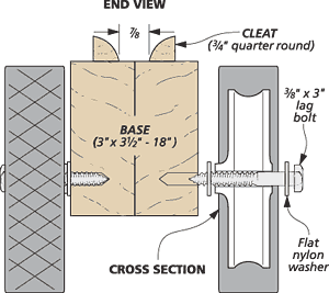

    You could build yourself a lumber cart for the task...

          Here's one you can build: http://www.woodworkingtips.com/etips/2007/07/27/ws/
          And another: http://www.woodmagazine.com/woodwork...t-goods-mover/

                I have one of those HF hand carriers like JR posted. I also made this carrier out of scrap 2x4's. The groove is 1" wide, and it rolls like a dream. If you don't want to hand carry, this works pretty good.
