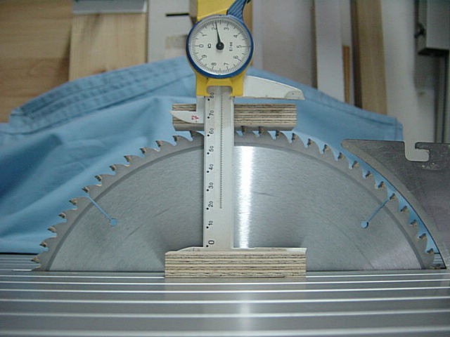

shop made height gauge
  • kramer katt
    • 375
    • SO CAL, USA
    • BT3100 and Craftsman 100
    credit to ShopNotes and Woodsmith
    clever reuse of one of the cheap plastic HF digital calipers. I believe under $10 when on sale
    or maybe you already have a broken one!
    http://www.woodworkingtips.com/etips/2008/06/19/sn/

          • 22106
          made a few myself
          http://www.bt3central.com/showthread...t=height+gauge
            That's a pretty nifty way to set up a gauge. I don't go to that extent or need that much accuracy. As for depth measurement I use this type of gauge. I don't get into measuring in the thousandths. I may use a combination square or a tape or steel measure for height of the blade.
            For cutting tenons, or shoulders, there's a line marked or knife marked to cut to. No need to measure for that. If I can get to 1/64", and possibly split the line, that's as close as I need to get.

              Loring,
              yours certainly have several advantages over this one. Two I see right away are the fact you can take the dial gauge off to use for other purposed and also the end of a caliper bar is not really meant to be a measure point.
              I am not sure why they call for the gauge to be glued into the arch of plywood.
              Seems it would stop you from changing the battery for one thing
              Do you purchase or make the different end caps for your dial gauge?

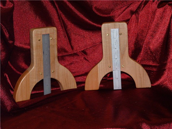

                Another version, from Shopnotes (I think)...
Name:	Bit height guages.JPG
                  • 22106
                  Originally posted by kramer katt
                  Loring,
                  yeah, its a requirement to me to have a flat contact on the end of the dial gauge if you are measuring the cut height of blades an bits since putting the usually supplied roound end against a point is very difficult.
                  I describe where you can buy or how to make your own in an article... PM me with your e-mail adress and i'll send it to you.
                  as for attaching the gauge, I have a split in the ring around the gauge that can be tightened with a screw hole threaded on one side of the split.
