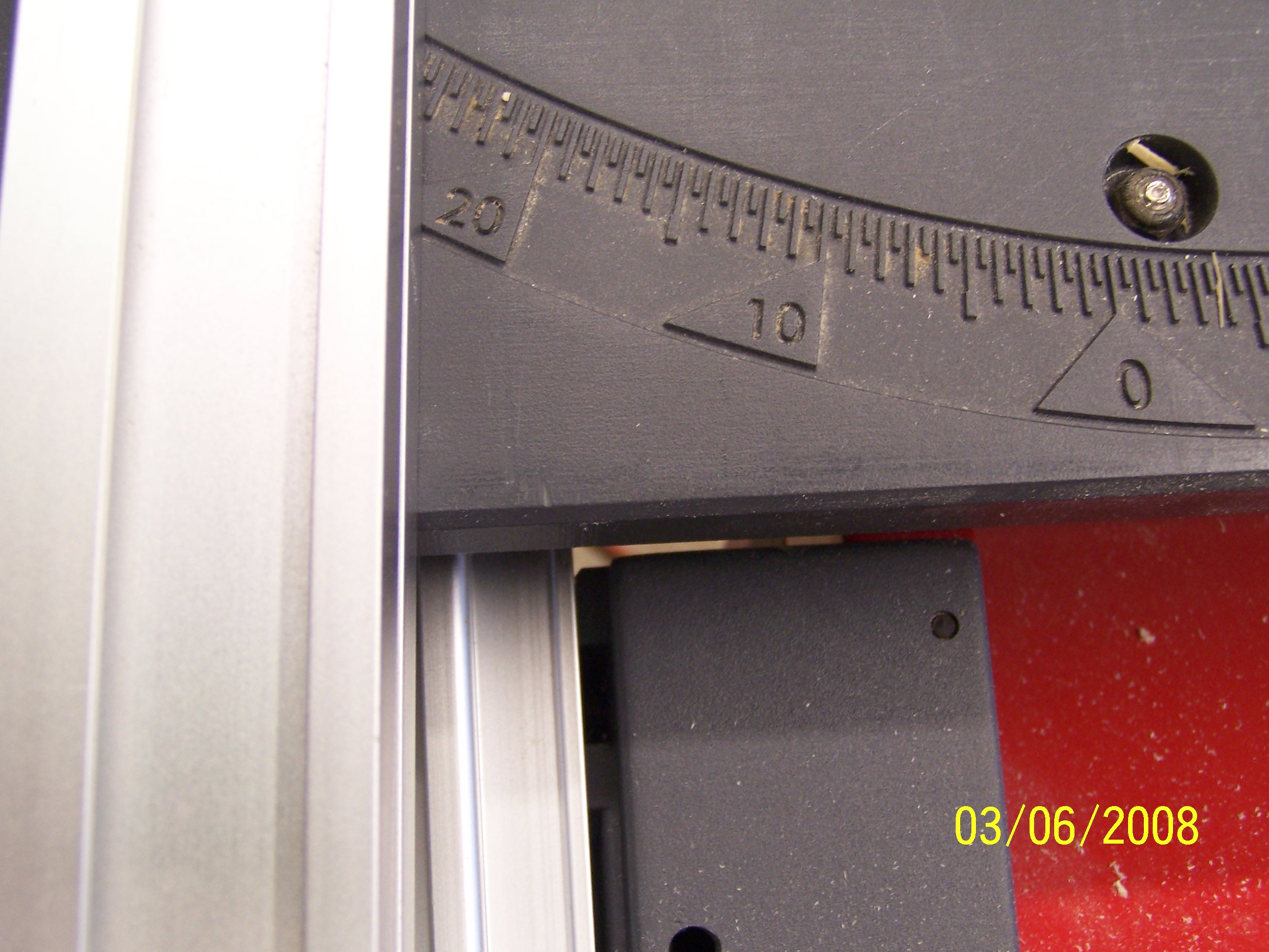

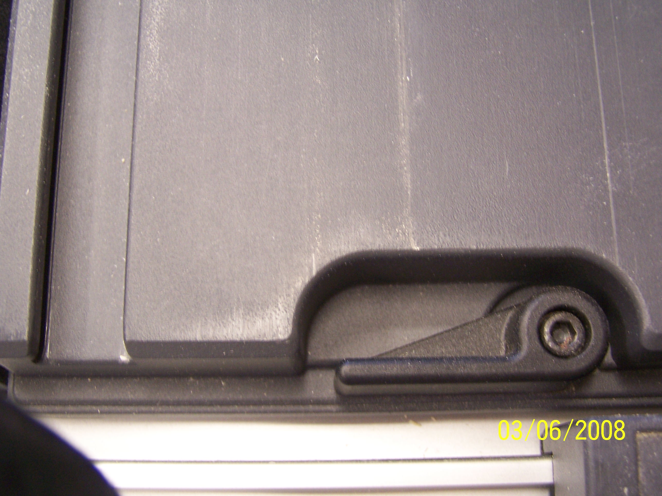

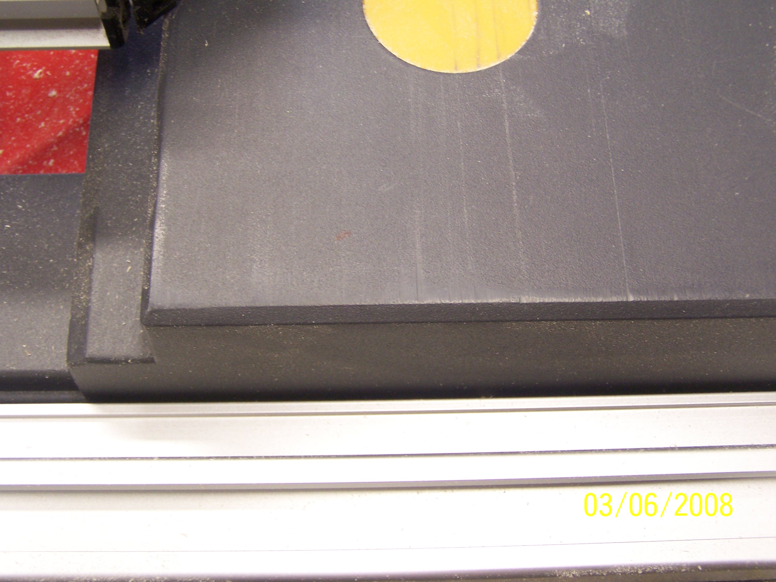

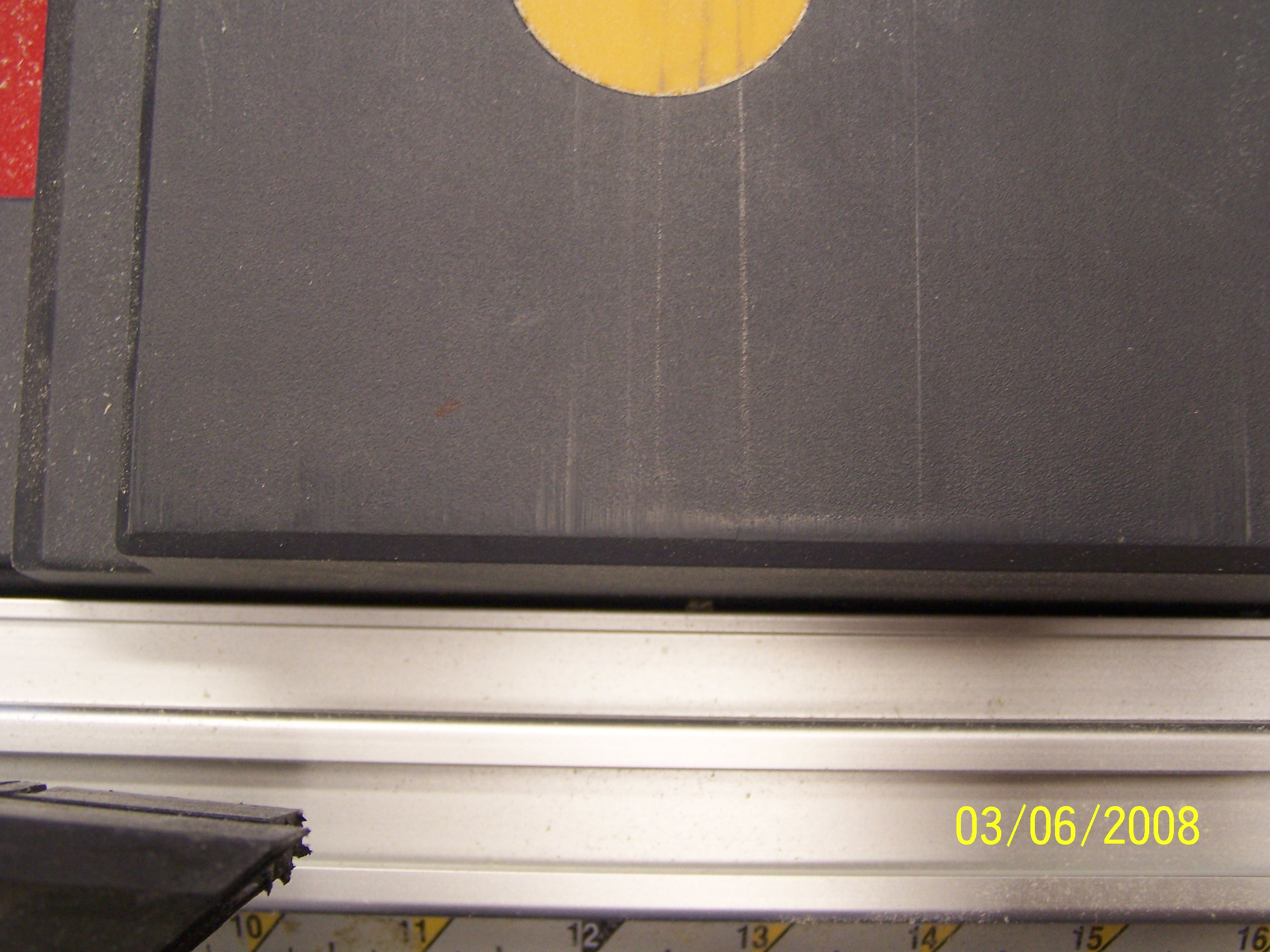

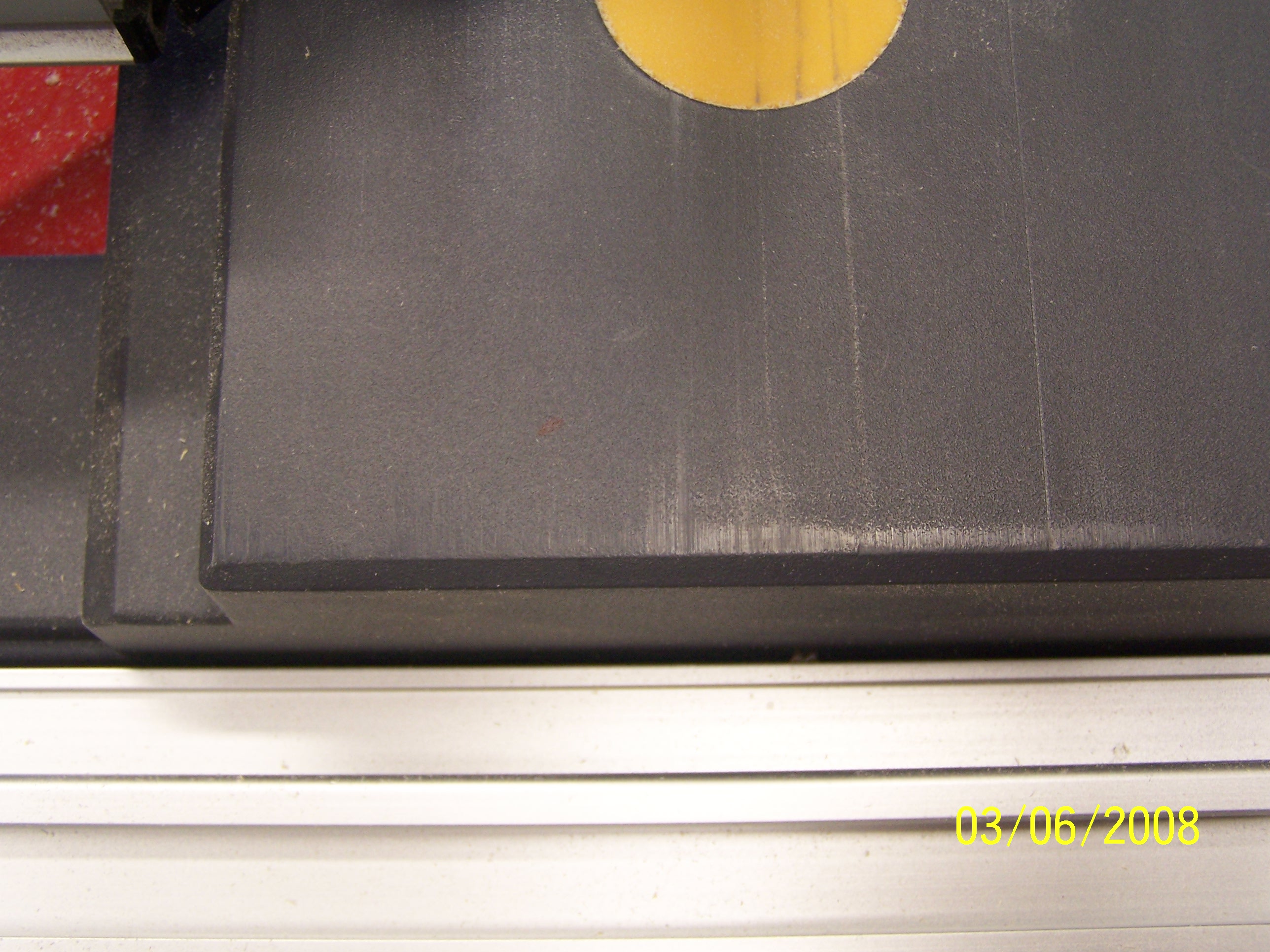

                I looked a little closer tonight at the gouges/scratches. I guess the best way to describe them is as shallow grooves along the edges of the front and back of the main table and a few along the side edge of sliding miter table. Odd thing is that the top coat is prefectly fine and shows no signs of chipping from the grooves. The grooves are deep enough that I can feel the uneven surface when I run my finger over them and can see them. I have mostly cut plywood, pine, and masonite on the saw since I have owned it. I guess I am just expecting a solid top and probably should consider that it is made of aluminum and not cast iron. This is my first table saw and I am a little picky I guess the positive side is that I haven't had any drag problems except when the guard catches.

                      You know, I've looked closely at Nahm's Unisaw (well, as closely as you can look on TV), and it has scratches parallel to the fence as well.
                      And I've seen pictures of Inca saws (that are hard anodized and very hard aluminum tops), and most of them have parallel scratches, too.
                      So I wouldn't sweat it. I would keep it waxed. I would avoid scratching it carelessly. I think removing the springs for the kickback thingys is a good idea, too. But I wouldn't stay up at night worrying about it. The more marks, the more it has been used, the more fun you've had.
                        i can see how a perfectionist woud be disturbed by the wear marks on the 21829 table tops.
                        The original BT3000 had hard anodized table tops with grooves and the top of the ridges were machined flat after anodizing.
                        The flat machining did away with the high spots near the front edges that show wear on Maxxie's table top and the overall grooves reduce friction somewhat and camoflage any wear lines. While the aluminum is still soft the any scratch lines are parallel to the grooves and just don't show.
                        I'm sure the anodized and machined tops were more expensive to produce than the powder-coated ones, that's one way they reduced the price so much to make the BT3100 (original powder coated tops) sell for $300 when the orignal BT3000s were $500.
