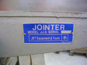

            This may be a REALLY OLD version of their machine. It belonged to the owner's father, so not really sure how old. It seems very well built(in Taiwan according to the badge), very heavy and (based on the fit, finish and mounting holes) the stand appears to have been made for this machine. There is no dust collection chute (just a square opening in the top of the base, so I'm also in process of adding one.
            I think it is too old and too well made to be some sort of knock-off but I could be wrong of course.
            Machine ran well and everything worked fine except for the guard which I have just finished adjusting (spring tip had broken off).
            Attached are some additional photos of the badging, in case anyone is interested. I'll take some shots of the underside while I have it visible and post if anyone wants to see it.
            For "a buck 25" so far I'm hopefull.

              That jointer looks to be in remarkable shape. For $125 I'd grab that up before it gets away. Some of the import stuff from years back is much higher quality than todays import stuff. The fence is a little old style but once you have it setup properly you probably won't move it very often anyways. I think it was sometime in the late 90's that Jet switched from that color scheme to the current cream color.
                • 22106
                ok, maybe you got a gem there. Real old Jet, for sure.
                  • 22106
                  this one's just gray-painted, looks to be original and not a user paint job.
                  Jet went through a puke-blue color scheme for a number of years and then the current cream. Don't know the years, though. Both hte logo and color scheme date to before my awareness of Jet tools.

                    Spent most of yesterday (good break from a back-breaker landscaping project) cleaning and inspecting my new (old) toy. I don't think this puppy has been used too much. Didn't look like the knives had ever been sharpened..still had the factory striations on the bevels.
                    Paint on the tool itself is original with some scrapes...not from use but probably from being used as a place to set things down. Underside was actually painted at the factory with primer. Checked the user wiring and found that ground was disconnected in the On/Off switch...fixed.
                    Just goes to show if you pick up a used tool be sure to check out everything.
                    Sent an email to Jet and (surprise) got a response within 8 hours. Rep says they switched from "blue" to "white" in 1998/99...funny I thought their current logo was red/black. FYI, the "logo" on the tool looks like a jet fighter on front profile within a circle. Will post a close up soon (if anyone cares...).
                    Loring, I'm not sure of the difference between "puke blue" and "barf white" but do you think it may have something to do with the aliens I've heard about that are sneaking over the border from Roswell into Lubock? If so, do you have any photos?

                      jet history says they used blue green orange and white paint schemes at various times since the 80s for woodworking tools... nothing about gray, tho.
                      example of an old "blue" jet bandsaw.
                      http://lh4.ggpht.com/JETFIFTY/R96dBe...ikeinshop4.jpg
                      • Hoover
                        • 1273
                        • USA.
                        Well the cream white dated from 1998 or 1999 is not an absolute. I have a Jet tablesaw born on date of 2001 and it is blue. Costco special, I guess Costco ordered some Jet saws in the blue color for a special sale.
