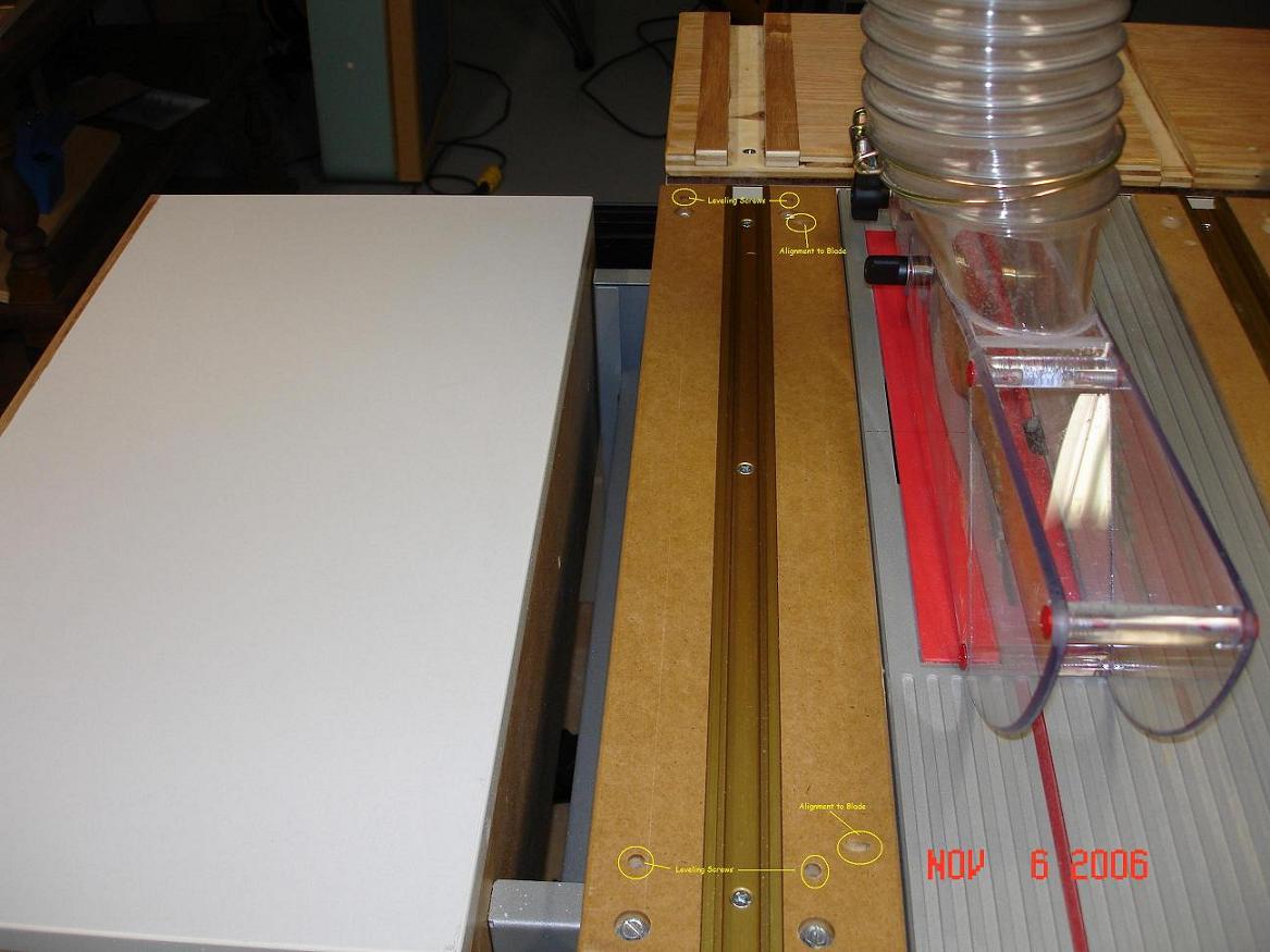

            Here's what I did for both sides of my BT. If you enlarge the photo, oyu will see that I have both leveling screws and alignment screws built in so that I can adjust in all directions.
              Jerry
              Jerry,
              I am about to build a right side slot. How did you do yours also how did you mount it? To the rails or the body?

                  Poolhound & steve-norrell,
                  Sorry for the delay in asnwering your questions.
                  1 If you notice in the pic, I have a 2nd, empty saw body mounted on the rails to the right of the functional one. This gives me a ledge to the left of the table top to mount the right side miter slot on.
                  2 The miter slot attachments are made of MDF; a piece of 1/2" and a piece of 3/4" glued together. Both are mouted to the saw body castings that protrude to the left of the table top. I drilled and tapped 10-32 holes in the casting for the mounting screws and drilled oversize holes in the MDF for these screws so that I can achieve some angular movement.
                  3 For levelling, I drilled and tapped 10-24 allen screws into the MDF so that they also went down onto the casting.
                  4 For alignment with the blade, I drilled and tapped 10-24 allen screws at about a 30 degree angle ; all 4 of these press against the functional saw body.
                  I hope this helps. I have had the left one for 3 years and the right one for 2 years and have been very happy with them. I don't have to adjust them unless I have taken the saw apart for some reason. The right one has to be checked after opening up the right side of the saw for the usual maintaince but it usually comes right back to the correct place if I am careful to get the extra saw body snug against the functional one when I tighten it to the rails.
                  I'll be happy to help further if you still have questions.
                  Jerry
                  Jerry

                    Jerry:
                    Thanks for the feedback and thanks for sending the email. Clever idea. Your system is quite different than the one I have been tinkering with. It looks as if you do not move the miter slots (except for maintenance) once they are installed. That's similar to what I have in the picture shown in my post.
                    The long miter table I am working on is designed to be moveable and, so far:
                    1. The table rests on the rails; uses 1/2 x 1/2 sliders to help position the table relative to the saw and blade.
                    2. It is held down against rails with screws through small UHMW blocks that are anchored to slots in the rear and front rails. (You can see the screw hole in the picture of the rear block.)
                    3. Horizontal positioning is controlled with the same blocks, by moving the table right or left and tightening the "T-bolt and nut" arrangements.
                    4. All mounting blocks are lower than the miter table surface so there is no interference with cutting larger stock.
                    This should be considered a "work in progress" that will evolve over the next few weeks. Hopefully, this will generate some additional suggestions.
                    Again, thanks for the feedback and for taking the time to send the email.
                    Regards, Steve

                          Mangler,
                          Try www.mowtownusa.com and search for BT3000. I just picked up 2 miter slots, clamps, etc for my Ryobi.

                            Huzzah! Thanks for the breakthrough idea!
                            I have a spare smt that I have been planning to use as a base for an easily removable and adjustable miter table. I have two of the aluminum ones but don't like having the left hand one in place all the time. It moves the SMT too far away from the blade for my tastes.
                            I am one of those that love the SMT, but would also like to be able to use a miter sled and jigs that require miter slots.
                            I have been trying to figure out how to mount the aluminum miter table to the SMT base plate - thinking through all the grinding and cutting needed to do it. Duh!
                            Having seen your design it suddenly comes together. Simply mount the correct thickness of MDF inside the SMT base - routed with T-track installed. Viola! An easy to add/remove miter table with built in squaring adjustments.
                            I had planned on cutting the SMT base to table width, but now see the advantages of leaving it long.
                            I'll report back on how it goes...
                            Doug Kerfoot
