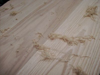

    I just used my hand scraper on a chest top after glue up. Took out what little glue line I had and a few slight ridges. I have found some (even some that are experienced) are either not that familar wtih a hand scraper or have tried one and got frustrated with not so good results.
    The not so good results will come if you don't put a proper burr on the edge and turn it. A hand scraper is not the choice in soft-wood.. so you won't get decent results there either. But.. a quick edge (once you get the feel) can lead to excellent results.
    The hand scraper is nothing more than a simple piece of metal that can produce the results of a fine hand plane without the expense or fiddling. It doesn't require expensive sharpening systems and a new edge can be put on in under 45 seconds once you learn how.
    There is much info printed and on-line as to how, but I thought I would snap a few shots of what to expect with it's pure simplicity. If you get dust rolling off your burr.. the burr is not turned correctly. You should get extremely thin shavings as you will see in the pictures. To do the chest top took about 15 minutes with no fine dust as you get with sanding.
    The top is ready for 180 girt.. 220 grit as the 150 grit can be by-passed with the use of the scraper in most cases. In some cases depending on species, the 180 and 220 grit can be eliminated. Just depends on the look you are trying to achieve.

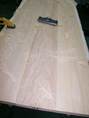

                You can definitley use them hand held as many do and I did for years. With a hand held (or with the LV scraper holder as I use) you can push or pull as it doesn't matter. With a hand plane.. you better learn to read grain and go with it as you will end up with the blade digging in if used against the grain in case you get careless.
                The blade holder can be an aid in two ways.
                #1.. The LV holder has a nut on the back that when you turn it, it bends the scraper blade in the middle to help skew. You can do that also hand-held... but it it difficult to hold the exact bend for long as you have no register.
                #2.. If you use it on a large panel as I have pictured.. the scraper will heat up from friction and it can get un-comfortable. It also can cause cramps attempting to maintain the same configuration of attach without mechanical aid.
