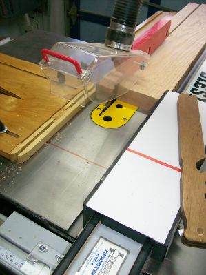

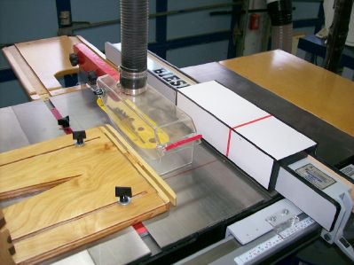

                          Here are some pics I took this morning of before and after the cut on stock 3' long.. 2" thick that was feed through rather rapidly to demo saw-dust control on another forum I was ask about. On that 2" thick stock the blade is raised about 3/4" below the gullet to give the best cut. There was no resistance moving it through rapidly. My hands won't be near a cut as I never violate my "red line" and have gaurds in place all around and above. So.. safety is considered before the cut with a raised blade.
                          The blade is an Amana 20 T Euro rip.. 20 degree hook.. flat tooth grind. This is important as the blade is made to rip and there are enough gullets to remove waste after the sever. A lower blade height would slow down the cut. I find just the right spot to not expose more plate than I feel necessary as sometimes too high will create resistance with run-out. BTW.. the blade is actually about 1/8" inside that upper crown gaurd as I slotted it to allow the blade to be raised to the upper teeth ride inside and not exposed.
