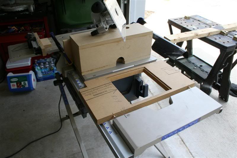

    So far I've only made a few test cuts and am pretty happy with it and the portability cannot be beat. Ive pretty much completed a drop in insert/attatchment for a router table out of MDF. So I think I'll be able to get by for awhile.

          I've decided its not so bad compared to what I was using. The 2 major drawbacks is that there is no easy way to make a zero clearance insert and its just no where near as cool as a bt3x... But I did make a nifty little drop in insert for a router so I dont have to cram my router table into my trunk and built it in such a way as to be able to use the ts rip fence for most applications and a sacrificial fence for the closer cuts

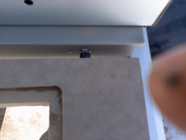

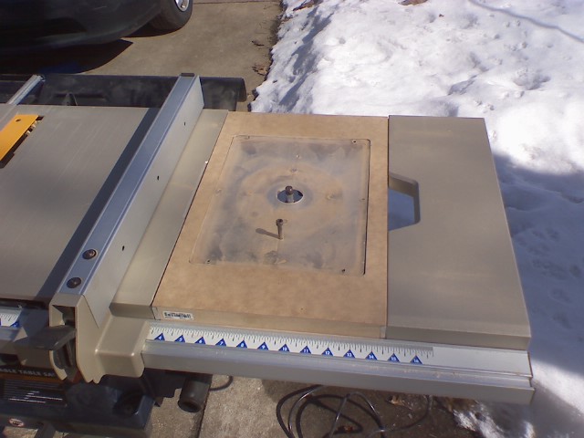

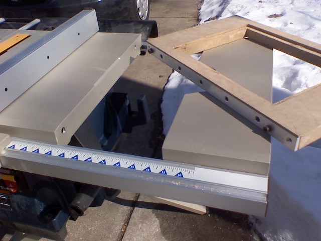

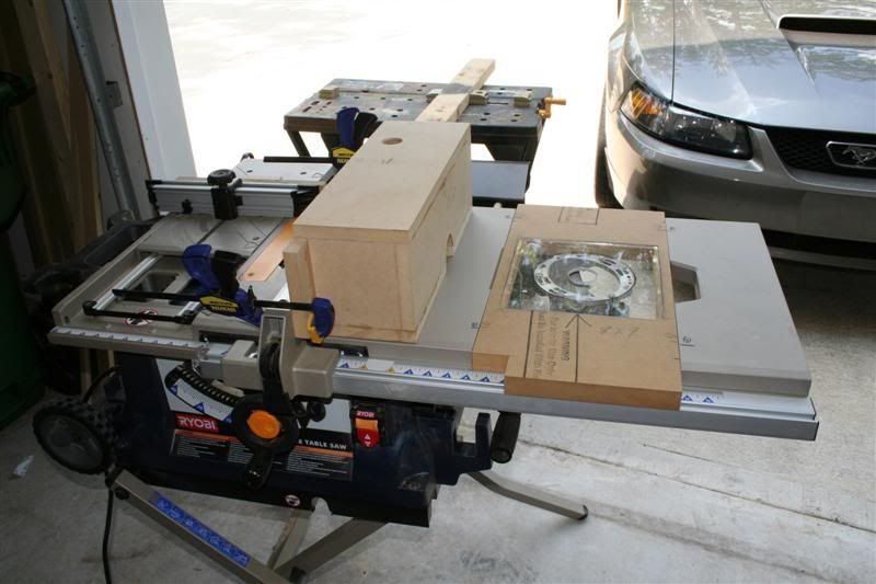

              The insert is nothing more than a piecs of 1 1/8" mdf with aluminum angle on the sides and the "table" has a cutout for a plexiglass insert... I drilled holes in both the side of the main table and the wing that were the same size as the head of allen cap screws that are screwed into the sides of the mdf insert... extend the wing out and then line the allen heads up with their holes and then slide the extension wing back in and lock it in place. I can send A pic if you want but you cant laugh at my bargain harbor freight router lol
              It works but it was probably more work than it was worth.... but I enjoy doing stuff like that...

                    I actually used a stair tread from lowes I think...it was somethin I had laying around... as for the 1/4" plexi it seems to work fine for me... Im gonna figure out how to do pics here in a second...
                    • unclecritic
                      • Feb 2008
                      • 99
                      • Michigan
                      • Craftsman 21829, (2) bt-3100's
                      I hope you can make sense of all this... I actually dont have the saw any more but I do have the insert... if your interested send me a pm...

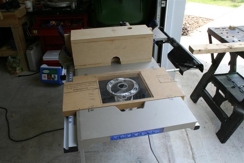

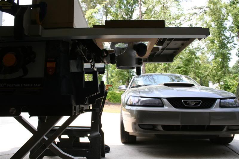

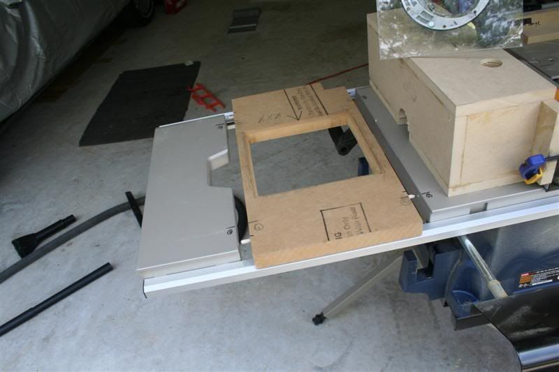

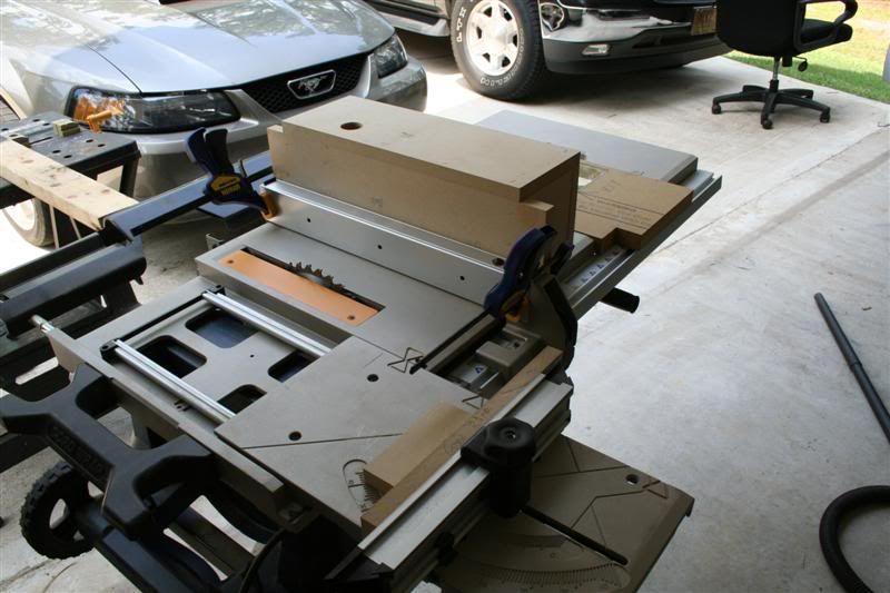

                          thanks for the pictures and info. I think I've finally finished mine. Only took me 3 months
                          I knew I wouldn't be able to extend my fence all the way over to the bit, so I made an extension box I saw in a magazine somewhere. Has a port for the shop vac and all
                          One thing I did a little different is I used wood dowels to hold it in place, but cut the table long enough that I could lay it over the edges of the saw (if that makes sense)

                            overall, I'm pretty happy with the saw. For what little work I do, it's perfect. Once I have a shop, I'll get a nice cabinet unit, but this one does the trick. I like that I can fold it up and put it out of the way.
                              Looks like that ought to work nicely.
                              You might consider adding a t-track to the top of the fence for feather boards and such. The router fence I made for my 21829 didn't have one at first. It didn't take me too long before I found the need for one.
