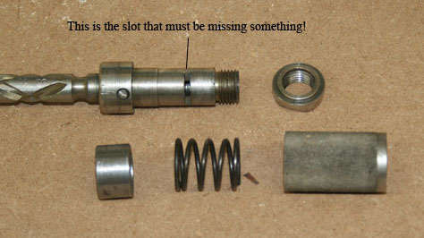

    I have an older model No.4141 Craftsman Ratcheting Sprial Drill Driver that I want to restore. It is in mint condition except it is missing what ever fits inside the chuck and holds the bit. There is a small slot with nothing in it.
    I would appreciate any information you might have.
    Are you sure? Do the bits have a morse taper? if so that could be the take apart slot, for lack of a better word.

      No morse taper. The bit has a notch on the bottom that forces it to align with the slot. When aligned, there is a "v" in the bit that corresponds to the slot in the chuck. Something, either a small half moon key or a small ball bearing must go into that slot.

        what does the inisde of the collar look like? any grooves, slots, etc?

          Perfectly smooth with a taper. I think I found the answer on another woodworking site. It is a half moon woodruff key.
