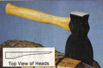

    The hatchet is the short little doobie, the axe has the long handle. While neither is used too much in woodworking for most, they do have their place in the craft. This is about the "broad hatchet and broad axe". It's used a lot in rough woodworking, and timber framing. The design of the head as you can see in the picture has one flat side, and the other is ground to a bevel. As a hatchet, it's used usually after the rough work was done with a broad axe, by smoothing up surfaces, or chopping corners off square timbers. I've used one of these with a heavy mallet in lieu of a wide chisel as the cutting edge is around 4 1/2" on some brands.

      Before the advent of the 'lectric powered saw, woodworkers dreaded rip cuts on long boards. Even in the production of very fine furniture pieces, single bevel hatchets like the one pictured were very often used to hack away much excess material close to a line. The work would then be cleaned up using handplanes. This was generally in the cases where more material needed to be removed than could be done quickly with a plane.
      Stopping cuts would generally be made across the grain, then thick shaving cuts taken with the grain. The stopping cuts would prevent splits from running into the area you wanted to keep.
