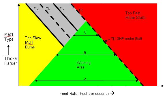

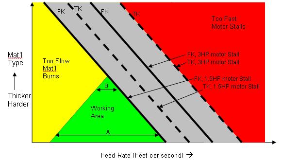

              Most of the above posts indicate that the use of TK vs FK results in a satisfactory, if not equal cut. If cut quality is not a problem then, I'll attempt to show why TK improves your life.
              Assuming the friction forces on the side of the blade are negligible then the simple reduction of plowing or cutting .100 wide path vs. .125 wide path is a 20% reduction in effort or work.
              If you assume some portion of the effort is side friction then the net reduction in force for the same feed rate is somewhere between 0 and 20% for going to a thin kerf blade.
              I've tried to explain it before, but the forces encountered and the motor power may make a great deal of difference in you woodworking ease.
              Two factors set the appropriate feed rate:
              One is the fact that if you feed too slowly you burn the cut.
              Two is the fact that if you feed too fast then the motor bogs down and stalls, an undesirable condition.
              I've made a chart illustration this compromise.
              In the first chart (you may wish to click on it to enlarge and read the detail) I show the relationship between feed rate and material.
              If the relative hardness and or thickness of the cut material increases, then the cutting effort increases. Also the tendency to burn increases. As you can see, yellow area shows the tendency to burn, too slow (to the left) and increasing hardness/thickness contribute.
              On the right, the red are shows the area where the motor stalls. As the thickness/hardness reduce the you can feed faster and not stall the motor.
              The slanted lines labeled FK, 3HP motor stall, TK, 3HP motor stall etc. indicate that the feed rate at which it stalls is a function of the TK vs FK and the motor HP. A thinner kerf presents less load and will permit a higher feed rate. A higher 3HP motor will also permit higher feed rates.
              A working range in green is where the saw operates best, no burning and no stalling - that's what you want. The range of feed speeds indicated by A for thin, soft material is wide. But as you go to thicker and harder material (more work to cut) the range of speeds is much less, more critical and harder to feed. At the place indicated by "B" you have to keep a steady feed rate with little margin faster or slower to keep from either burning your wood or stalling your saw.
              In the first plot the green are is indicated for a full kerf, 1.5 HP saw.
              The Gray area represents the possible improvement of using thinner blade or more powerful saw.
              The second plot shows what happens when you go to a higher power motor and a thinner blade. The green working area becomes much larger.
              The range of working feed rates for A is much greater. The previously small range of acceptable speed for B is now wider (you can go much faster), and for material of a hardness and thickness indicated by "C", this saw/blade combination will cut it whereas the full kerf, 1.5HP motor could not properly cut it at all.
