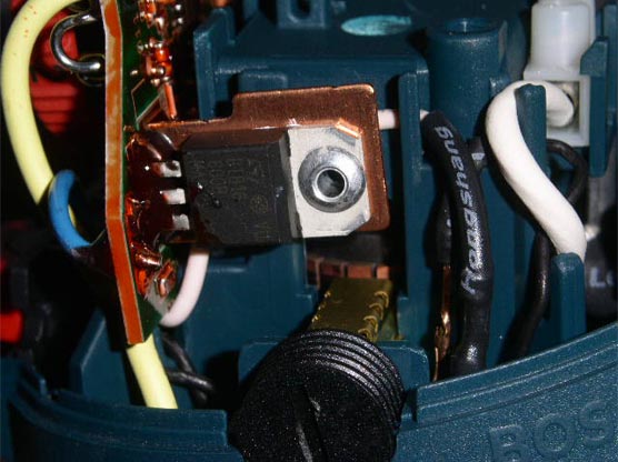

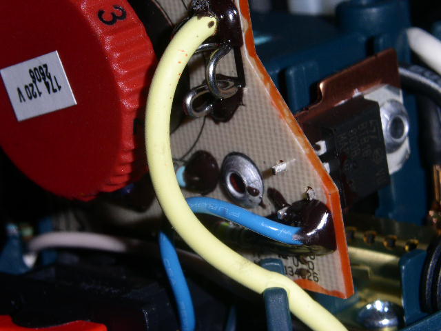

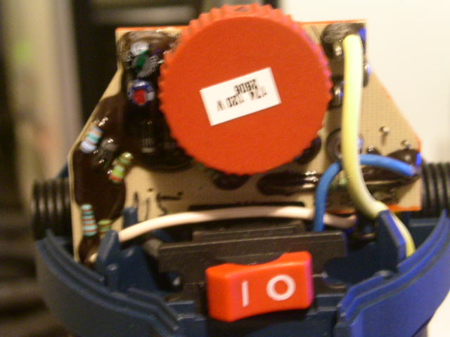

                    Here are some pics if this helps. Loring I'll try out the spray.
                    -Paul
                      That's solid-state, alright. Contact cleaner is worth a shot, but don't get your hopes up. If given a choice, use a contact cleaner that says it's zero residue. Anything else is probably gonna gum you up even worse.
