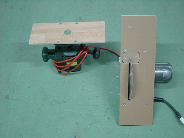

                And I'm using....Floor panel....8mm (5/16") HDF, covered with Formica on both sides, very slippery, 15 years guaranty for walking on it...
                After you drill the mounting bolts holes, put Super glue on the hole counter-sink and the hole itself and let it dry (penetrate) for 10~15 minutes, the counter-sink and the hole will become "iron".
                As you can see, It's not limited only to the router...
                Best Regards
                niki
