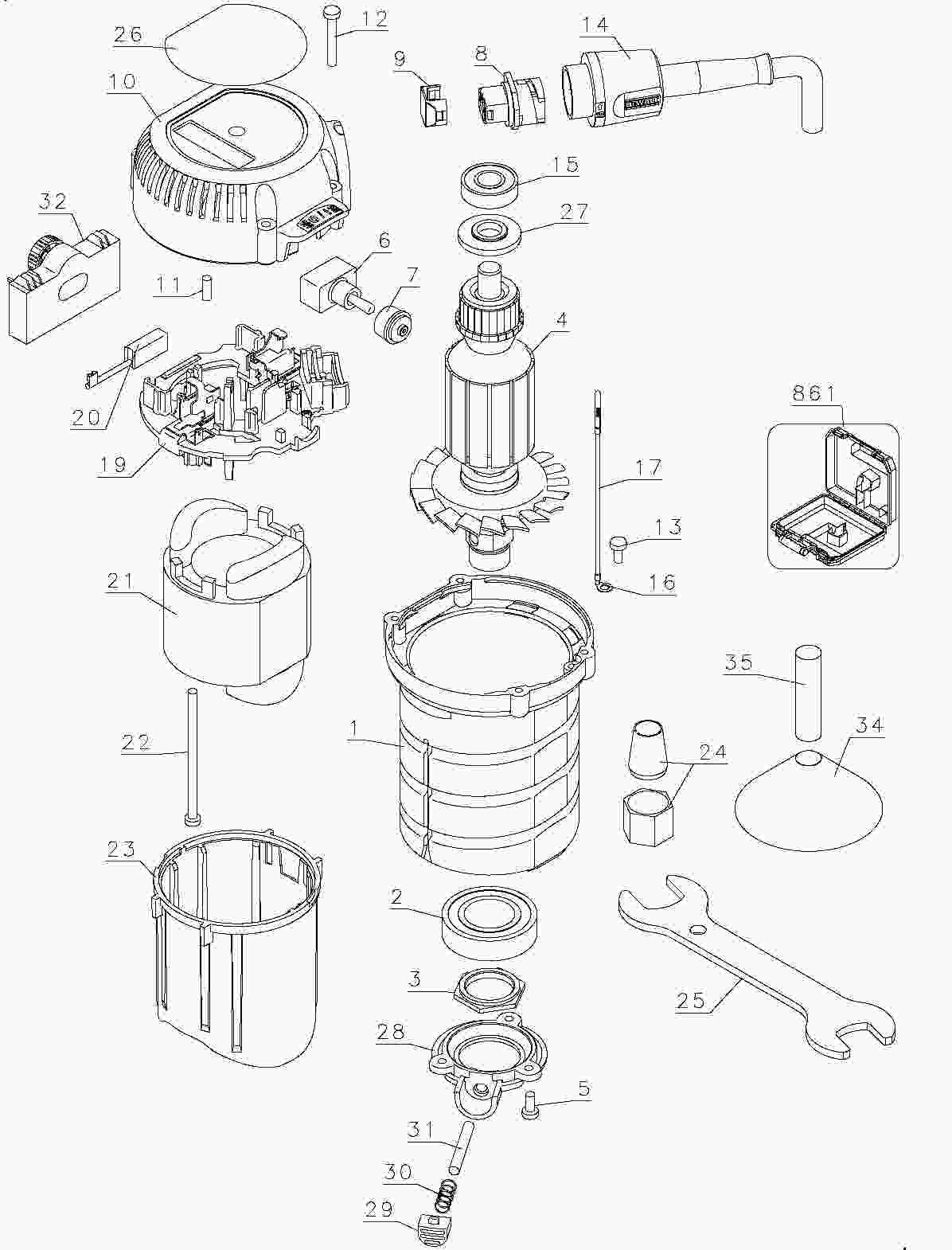

    I just went thru that procedure. In my case, and maybe your's too, under the top bearing (there's two, one on top and one on the bottom) there's a "magnetic ring", which slips on the armature shaft before replacing the bearing. The ring has something to do with the speed control, and mine shattered. But the noise was there at rundown.
    To remove either the bearing, which you have to do to replace the ring anyway, you need a bearing puller. one with a thin set of arms, as there's not much rom between the bearing and the ring. To get to the assemblu, just remove the four torx screws holding the top plastic "cap" onto the body.
    I used a drill press (unplugged) to press the new bearing back on.
    I'm giving you Dewalt's usernet web site url, where you can download an exploded view of the router and a parts list, there's also a locator for finding a local service center to do the work for you. Shouldn't cost too much, the bearing is $6.00, and the ring is $2.50.

    The exploded drawing shows the ring (it has a collar) direction when replacing, but it doesnt show which side the blearing goes gack on. It's the all metal side up.
      Thanks Bruce!
      I think you forgot the link. Any chance you could post that? I could probably find a link but then if I have questions it would be nice if we were both looking at the same drawing.

        http://www.dewaltservicenet.com/ServiceNet/logon.asp

          The diagram shows two bearings (which makes sense I guess). It sounds like the one you replaced was pretty easy to get to.
          How did you know that only that bearing needed replacing? Is it a common failure? I'd hate to replace only one bearing to later find out I needed both or the other.
          I wonder how difficult it is to get to the larger bearing that is closer to the bit. It would be nice to just remove the three screws that hold on #28, and the nut, and then get to the bearing.
