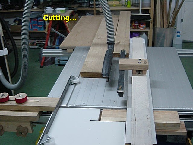

                    Hi Rod
                    I made them long time ago for the table saw...very relaxed when cutting especially big long boards.
                    The hold-down ones are located, one before and one after the blade.
                    Both are angled to the right so they also push the board toward the fence.
                    The Feeder wheels, are located both before the blade and both are angled down so they push the board down to the table.
                    niki

                      Originally posted by niki
                      Hi Rod
                      niki
                      Thanks, Niki
                      You obviously get your "flex" from the length of the bars.
                      Downunder ... 1" = 25.4mm
                          Hi Rod
                          niki
                          I'm inclined to think that your use of the distance between the wheels and the tension of the bars would offer more guided support. It just looks safer, and besides it would cost a lot less.
                          • niki
                            • 566
                            • Poland
                            • EB PK255
                            Cabinetman
                            You are correct, the distance between the hold-down wheels is 17" and the feeder rollers, 18".
                            I'm not afraid of the TS but I give him all the respect as one that is stronger than me (1/8 HP comparing to 3 HP )
                            When I use both of them I feel very safe and relaxed (but still, very concentrated in what I do), I just push the workpiece and I can feel that it's held down and pushed to the fence very firmly.
