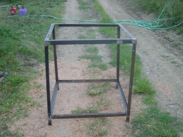

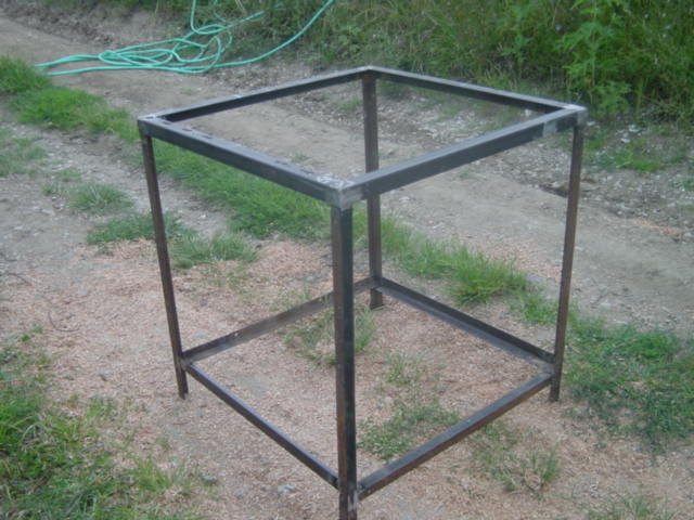

      ok well i got the frame done
      i'll post a pic today some time. i cut all the pcs with my 4" angle grinder , the plans called for 5/16" stove bolts i decided to weld everything instead. its pretty hard to adjust things when they have been welded . i miscalculated some measurements and had to cut and reweld 1 corner
      i used what i had or could find , i used 1 3/4"x1 3/4" 3/16" angel iron for the top and 1 1/4"x 1 1/4" 3/16" for the legs. but since i've been sitting here thinking about other parts of the saw and and trying to figure out how to make all the pcs come together. i wish i would of used square tubing for the frame. i'm thinking i might look for some and build a second frame and see which one i like better. it would add more weight which is a concern of mine right now

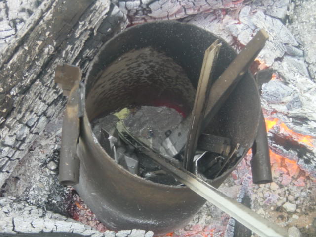

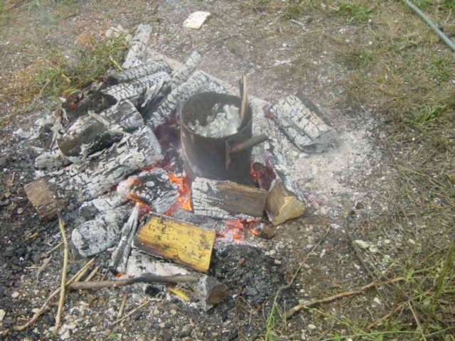

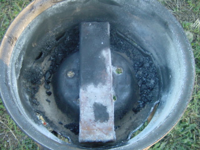

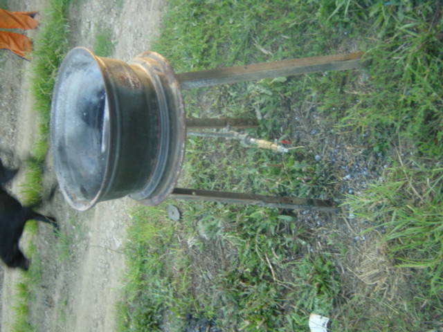

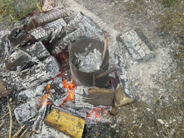

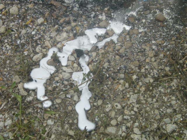

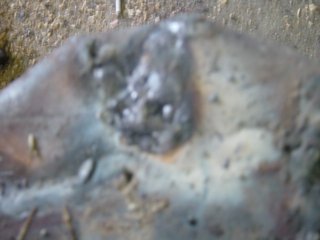

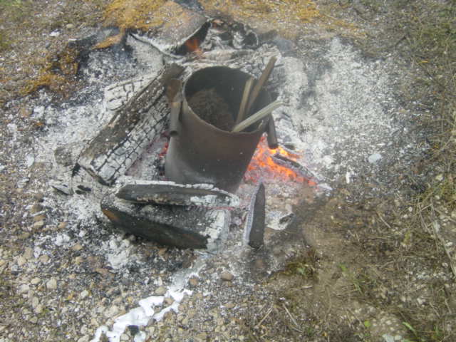

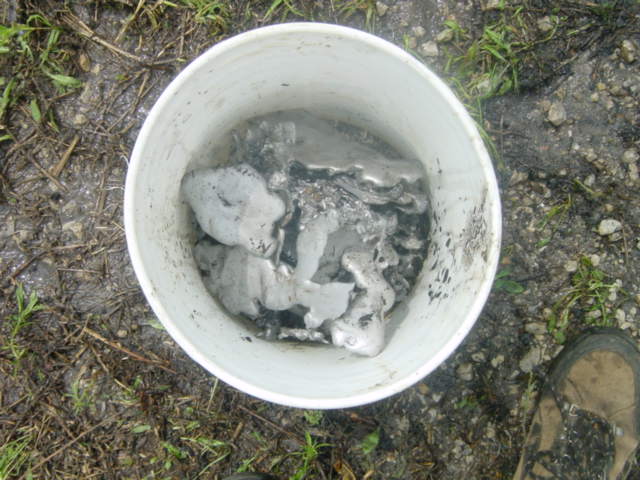

        here some pictures of me melting a test batch of aluimum i'm just playing with it right now i still have alot pcs to find to complete this project
        first pic, this is the first try at melting the AL. you can the stream of melted AL from the hole in the crucible
        second pic, the stream of melted AL again
        third pic, looking down into the diy crucible.
        fourth pic , really blured shot of the welded hole
        fifth pic, this is the second try at melting the AL
        sixth pic, again looking down (kinda, it was really hot) into the crucible.
        the seventh pic, is the aftermath of the spill cleaned up. i learned alot about melting metal today
        something you dont see in the pictures is how i was getting the fire hot enough to melt the AL. i was buring maple and hedge(osage orange) hedge is the hotest burning wood there is a full cord puts out 33,000 btu according to the univ of missouri web site.
        anyway, i used my air compressor to force air over the burning pcs of wood to super heat the crucible. at times the crucible was glowing red half way up. i need to learn to take more pictures for you guys,but theres just to much going on to stop and snap a few pics

                  #23
                  and here is the frame
                  it looks crooked in the pic but its its not
