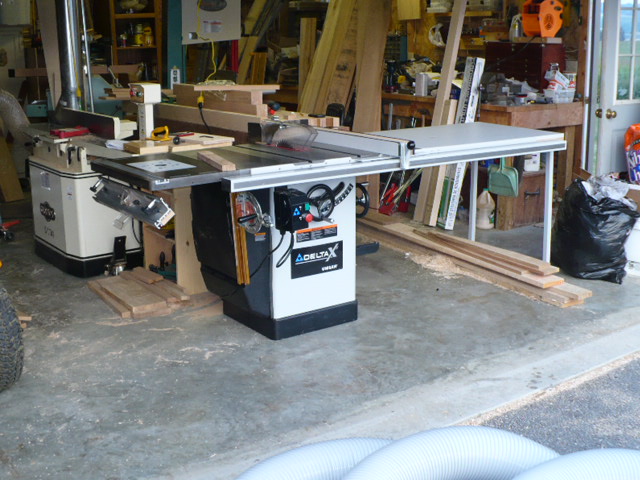

    Got tired of waiting on Amazon to send the Jet TS deal, so I caught a killer deal on Amazon last week for a Delta X5 Uni w/50" Biesy rails. Had a Bench Dog CI router wing to add to it. Stuck full kerf Ridge Carbide TS2000 in it and am just pleased to death!
    Only problems encountered was the fence was very tight against rails even with pads turned down. This caused the slick plastic pad to pop off the lever that locks fence. I am going to epoxy it back on. Getting the wings level was not fun. The Bench Dog wing was the easiest. The extension table was kind of a pisser. It has a really nice hard thick almost phenolic looking bottom with a layer of some substrate then a decent grey laminate top. All in all decent stuff, but then they used stupid pine to trim it out with white glue and 18 gauge brad nailer, 2 nails per joint! I will likely rebuild with maple or oak while salvaging the main top materials.

    Congratulations! I love my Delta too! I replaced the cheesy extention table on mine too. No other complaints though!

      Did you replace the framing or the entire thing? I think the material is great, just the frame that stinks.

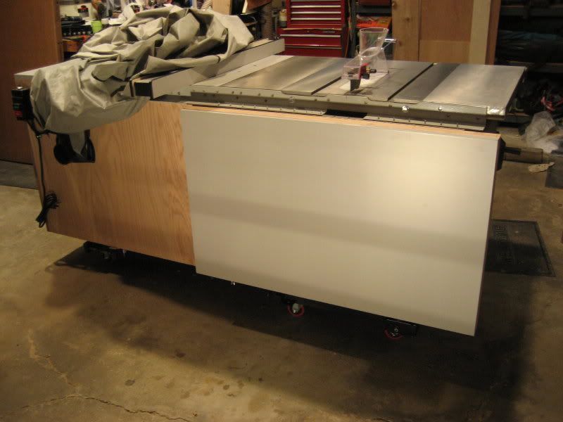

                    Looks like you are tight on space like me. I included a couple of pics of how I used the area under the wing for storage:

                        Mike,
                        BTW very nice cabinets! I am going to do the same thing plus build something for the other side where the Bench Dog router wing is in order to collect dust.
                        Would it be possible for you to get me a couple photos of how you attached the outfeed table?

                          How does the mobile base lock down? Is the the Delta base? The cabinet looks like it would cover where the flip lever belongs. Is the cabinet fully supported on the base or does it have its own wheels?

                            No problem. I basically used a piano hinge and drilled/screwed it to the rear rail (I know - you may not want to drill into your new puppy yet). I used shim stock to adjust the height of the table and used parts of a Sears roller stand that they had for $10 a few months back for table support. When I roll my saw out I put my Wixey angle gauge on the cast saw top and set to zero - then move it the to out feed table and adjust the leg height:
