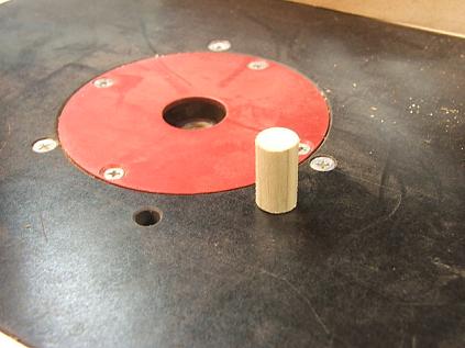

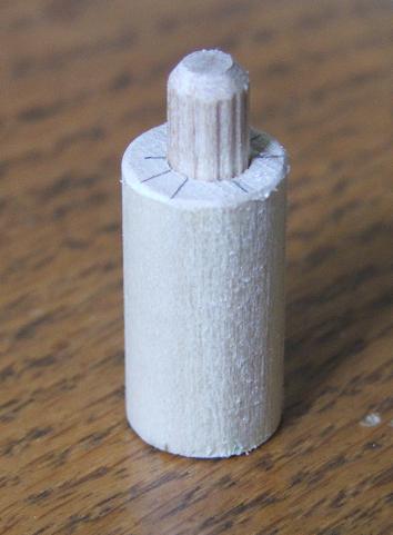

                  #23
                  DIY router table starting pin
                  Here, I made one in about 10 minutes of shop time.
                  Used approx 1-1/4" long 1/2" dowel and a store-bought 1/4" dowel pin.
                  Fits snugly into the 1/4" hole in my router table I have for the starter pin.
