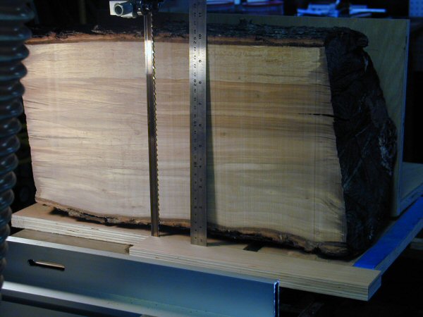

Like Bruce and Mike said, the Rikon 14" Deluxe is fantastic. I've resawed 12" dia. short logs and the Rikon didn't act like it knew it was cutting. I made a sled that rides in the miter slot and slice veneers to consistant thickness without a problem. I recently picked up a bunch of 4" x 4" x 8' White Cedar and resawed them into 4/4 stock. With a Blade Runner (Iturra's name for Woodslicer) the cut was so smooth a couple of friends couldn't believe they hadn't had a run through the planer. 2 light passes through the planer and the boards were ready to use.

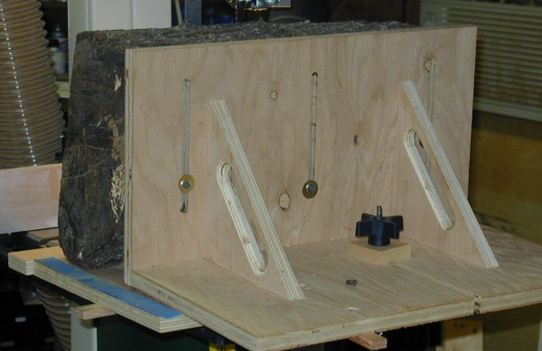

I don't seem to have a pic of the jig naked, John. Here are a couple with it clothed in a 10"+ chunk of Cherry. The jig rides in the BS miter slot and the bed of the jig rides in a miter slot in the base piece of the jig (for adjusting the thickness of the slice.. The jig comes apart and the top piece can be used as a high resaw fence. Here is a link to a ,wmv video of the jig in use, mms://st11g1.services.att-idns.net/v1/724/2223/wood/netshow/Resawing%20found_bb.wmvMorning Ken...

The jig was in the may 2007 issue of Wood, is available here, http://woodstore.net/fiyoownwoand.html

Thanks for the pictures.. post and links. I could have used that little fella when I took the 22" diameter sweet-gum down out front. Still got a 24" that needs to come down before winter, so...
I think I might build one if a spare moment arises. Off to work...
