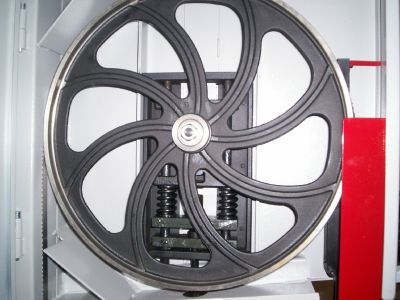

                              Howdy Uncle Cracker...
                              After doing an extensive 2 month search that culminated at the Atlanta IWF last fall where I was able to "compare all of them side by side".. here's what I purchased. Have a look at the BS's personally and let the BS tell you which one you want.
                              Compared to others I chose my BS as it has double springs.. re-enforced upper case arm.. re-forced spring mounts.. the best dust collection of the lot.. a larger hub and bearing case than the competitors.. a larger table and a 5 Year Warranty. Other than that, they're all about the same as the Steel City IMO.
                              Good luck with whatever you purchase...
