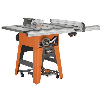

                          Okay, so I have narrowed my choices to what seems to be two or three saws. The Ridgid is sort of number one right now, next is the Powermatic 64, and finally the Delta 36-980. All three are shown here...
                          I think the Ridgid is the best bet as far as cast iron, weight, power, warranty, availibility, etc. I also have the Ridgid Planer, Oscilating Spindle Sander, Jointer and more. So the Orange and Gray will certainly match my workshop. Also, the Herculift seems a nice option for easy movement. My only doubt is the fence on the Ridgid. The Delta and Powermatics have the larger smoother fences, but reviews say the Ridgid is nice and solid.
                          Thanks to you all for your help. Any more feedback on these three would be great. Especially looking for commenst about the fences.

                            The powermatic fence is going to be the best of those 3 I'd bet. It looks to be the same one that is on my PM2000, which I like a good deal better than the T2 or Ridgig fences. There's rip capacity too, the PM has the advantage there. Herc-u-lift is certainly cool though.

                              I haven't touched the PM or Delta fence, Marc, and all I can say about the 3650 fence is that it is dead-on straight front to back, square to the table and locks tight exactly where you tell it to. That's all I ask of a fence and it does it well.
