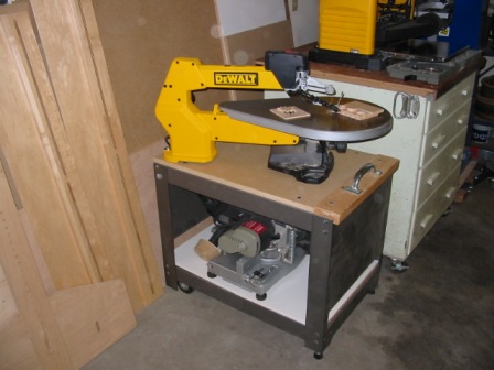

            Now... have also heard much good about the DW 3 leg stand adding to the already low vibrating DW 788 as opposed to a 4 legged stand. Not sure why that would be true? I do like the idea of the taper to the front so you can drag up a seat and straddle it with comfort. Was even thinking of making my own 3 legged stand from yellow pine and adding a hinged seat on the front that will flip up and lock in place, but fold down to conserve room when not in use.
            Anyone got a "take" on that 3 legged booger that might be of interest as to whether to buy or build! Again.. in-sight is welcome.

              Not sure, but it may follow the same principle as a chair or stool: one short (or long) leg on a 4-leg stool will cause all sorts of wobble, while it's impossible to have that situation on a 3-leg stool. The seat may not be coplanar with the floor, but unequal leg lengths will not result in a wobble. Just my .02

                  Yes, tri-pod would be superior. I was too cheap to buy it so I recycled my BT3000 stand and mounted it corner to corner to allow me to sit close.

                      I've had my dewalt for a while now, and have used it to cut fretwork, layerscapes, and mostly marquetry. I like it, good saw for the money. About the best I've used under 1k$. I just got the dewalt stand for it, and it's nice enough, though there isn't storage...

                        You mentioned not enough storage. I think I might follow the advice on the "tre-pod" for stability and build one from wood with storage under-neath. Then I could go "mobile" with a TRI by adding two casters to the rear of a wood base and a recessed larger locking caster to the front. That gives me a tri-pod for stability.. storage to reduce dead space and mobility to move it from one spot to another.

                          Nice, yeah, it's not so much that I need the storage there as it just seems a waste that there isn't storage there. It'd be vibrated a bit, as the saw does vibrate when on high speeds. I don't typically cut with it over about 75% speed though...
                          The dewalt tripod is also tilted, so that the saw is leaning toward you, if that helps at all.
