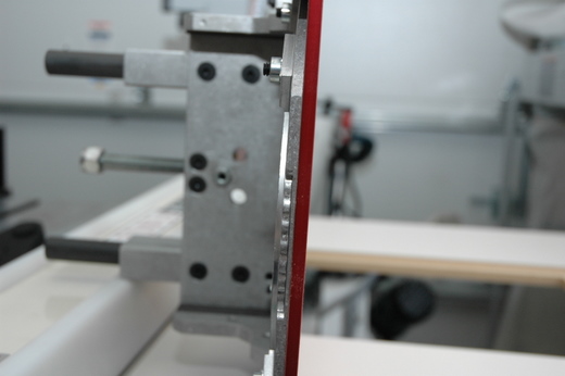

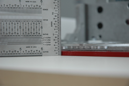

                        • GaryA
                          • 365
                          • Tampa, FL, USA.
                          #27
                          You probably don't even need a router attached. Just crank the plate up as high as it will go and see how far the top of the mounting plate is from the top of the table. Does that make sense?
                          OK, I'm getting 9/16" from plate to table top (see pics). So, what do you think?
                          Gary
                          • Jeffrey Schronce
                            • 3822
                            • York, PA, USA.
                            • 22124
                            #28
                            9/16" from where on plate? That darn plate appears to be pretty thick!

                              Guess it all depends on how much the Hitachi collet will extend beyond the base, once the plastic base guard is taken off. Looking at Bosch 1617 fixed base it would appear that this lift would be ok. A little tight on bit changing, requiring a bent wrench to get to the bottom part of the motor but other wise ok.
                              The Jessem Mast R Lift will actully take my entire motor about 3/4" above the table top! Mast R Lift uses router motor only. But it looks like the Jet maybe ok, again depending on how far the collet extends on the Hitachi.

                                #30
                                It looks to me like it's 9/16" from the main surface that mates to the base casting of the router.
                                That's not bad, but you'll also have to take into account how far a given router can lower its collet through the router's base opening.
