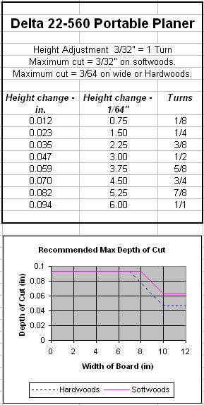

              I have the 22-560 predecessor to the TP400LS, same machine different name + a stand.
              First, yes, the dust hood is almost a must have. Otherwise the chips get thrown all over some end up on the infeed side and the rollers press them into the top side of the wood leaving dents -- ugh!
              I think the gauge on the TP400LS is about like all the other gauges. The real problem is, the height adjustment is 3/32" per turn, an inconvenient value. I always used this chart on the side of mine:
              The chart has turns in 1/8ths of a turn, that's convenient and easy to dial in. It also has the corresponding height change in fractions of 1/64th which is not really useful but a good relationship and the height change in thousands of an inch, great with a set of calipers.
              I measure the wood, determine the difference and can dial in very accurately the amount - the chart gives pretty much the range from zero to max depth of cut (see the bottom chart) and you can easily get to within about .012, quite reliably. Then I nudge the crank less than 1/8th turn to trim down to about the final .005 if I'm that picky.
              For example I want the final board to be .500 and its now planed to .528 according to my calipers. I need to knock off .028. I see on the chart its 3/8 is .035 (too much) and 2/8 or 1/4 turn is .023 (too little). So I turn the crank 1/4 turn, plus just a hair less than 1/8 turn and it will be pretty much spot on.
              I have the Excel spreadsheet for this if anyone want to print from that or modify it for use with some other planer.
              I love gadgets but I don't see a need for the Wixey TP gauge when I use the above technique... I never actually read the gauge on the planer, just use my calipers on the wood itself and figure the difference.
