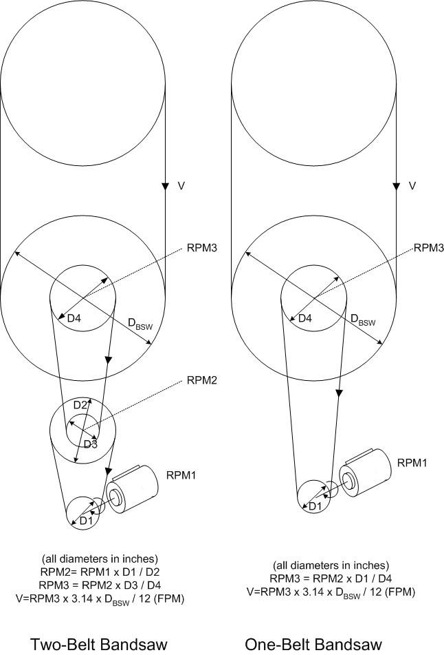

    there have been several requests for how to calculate the linear speed of the bandsaw blade given the motor RPM and the various pulley and wheel sizes.
    Here's a graphic with formulas showing the pulley setup for two-belt and one-belt bandsaws.
    This should be good for virtually all bandsaws you might encounter.
    (Click on the thumbnail for a full size picture)
