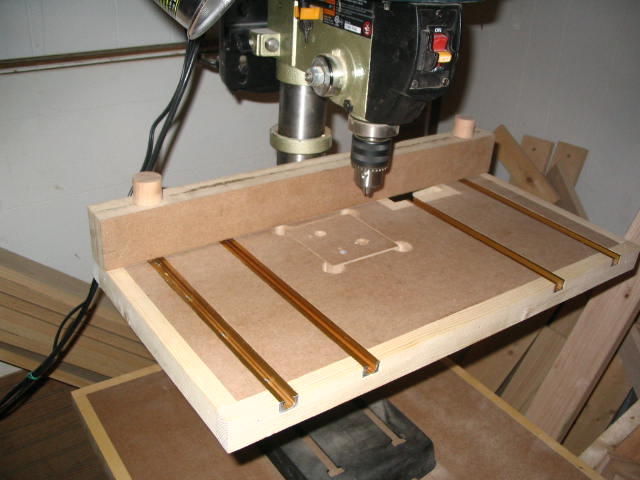

    P.S. The small table and poor fence is exactly the reason you need to build a table for it.
    A table and adjustable fence is really easy to build one youself. All you need is some T-Track ($10-20) and some flat wood stuff (I used a melamine-covered shelf board for my first one).

          The tables on drill presses are really a legacy of the DP being thought of as a metal working machine instead of a wood working machine. One of the best upgrades for my DP was to add a large worksurface. Some T track embedded in a laminated MDF table with fence made from hardwood stock. The T track allows you to use various stops, hold downs, and other jigs as well as making the fence easy to use.

                    If you are doing a lot of wood drilling, then the standard table that comes with the DP is very frustrating. it's short and hard to drill on the end of longer pieces, through holes are a pain, fencing, clamping, etc.
                    I built this table and my joy for using the DP sky-rocketd. Removable inserts, easy clamping fence, and accessory hold downs are great. The wider table allows the piece to sit easily without falling off the side. It does take more then a little bit of time to make a table though, although mine was cheap to build. But think of the table as it's own tool, it's important to get everything right. You can get aftermarket tables but most are the cost of your DP.
