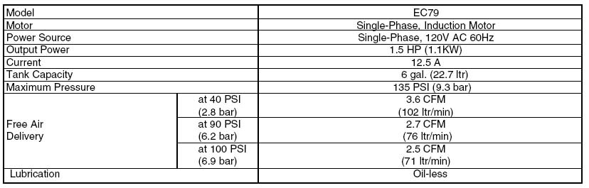

          I don't know what specs yours has.
          Here is the information:
          http://woodworkingdiy.googlepages.com
            I think that's OK with the Critter. Critter claims it'll work with 3/4 HP compressors with no tank (zero gals).
